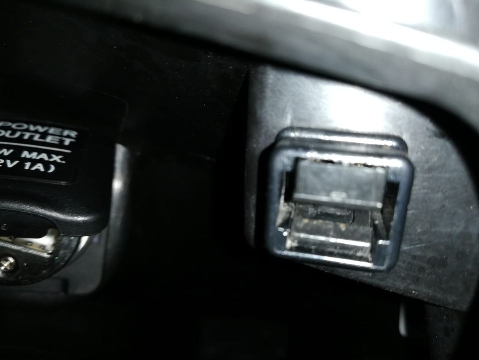

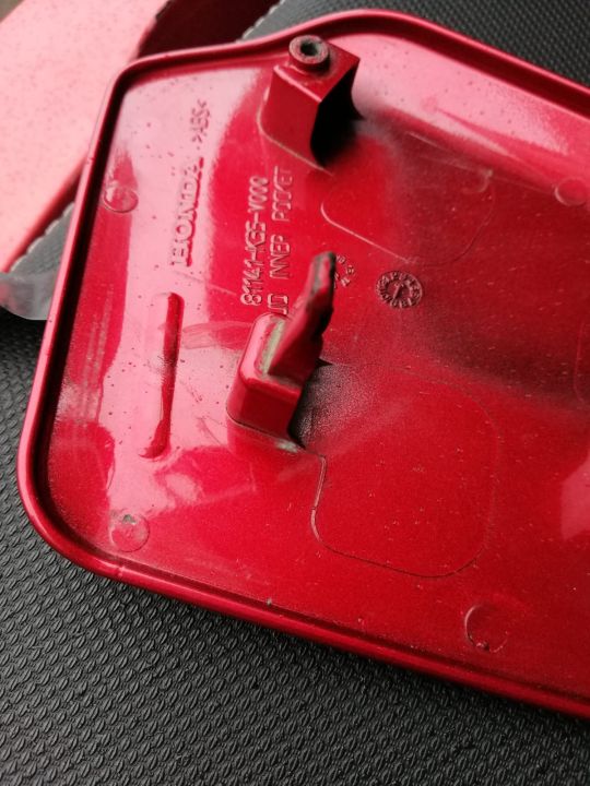

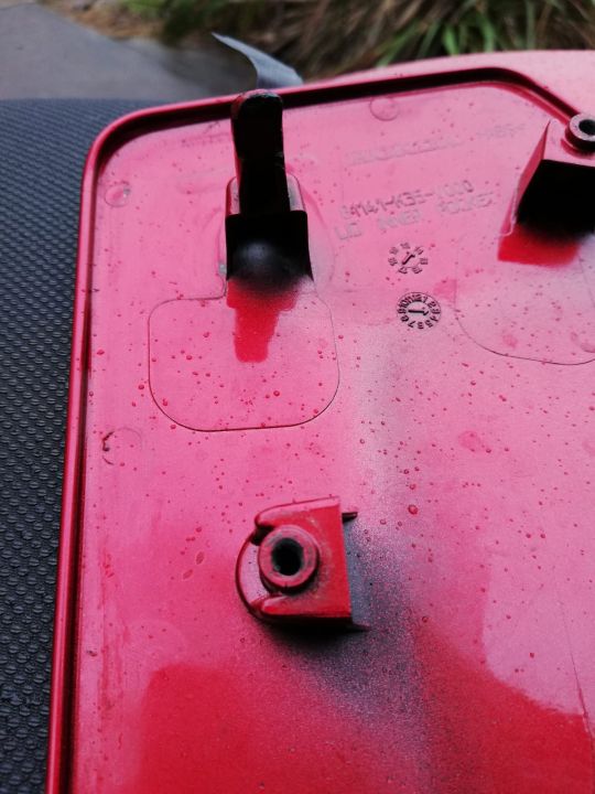

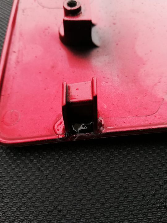

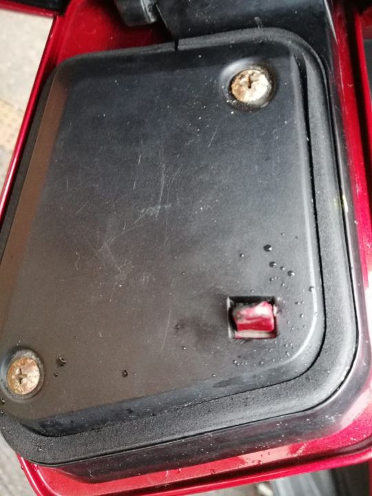

Here a few pics, any idea???

I am trying to figure out the pictures. Is picture #3 the door itself? If it is then it looks like the plastic latch is broken.
Is picture #2 one of the outer plastic body covers?
Like I said, it is a little difficult to determine from the pictures. However, usually the black part is the inside of the box, while the red is reserved for the outer cover.

It looks like the male part (colour red) of that latch is worn.
Difficult to see, but is there something inside the female portion of the latch?
If that is the case, you might be able to "build-up" the male latch with a bit of JB Weld and file to original shape.

Thanks guys for your feedbacks.
Female part seems to work properly under finger pressure, locking as expected, so most probably it's the male worn latch the issue here. Considering the limited cost I could order a new door cover or attempt to rebuild the worn part with some epoxy glue.
