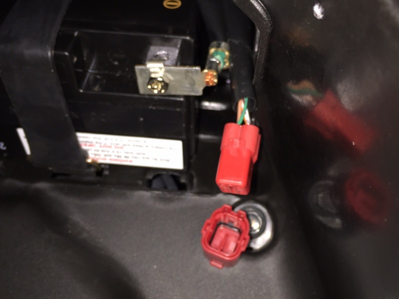

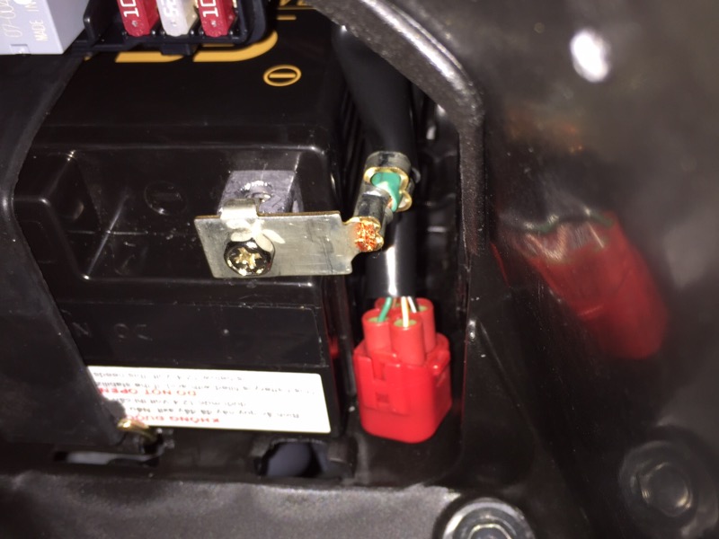

I noticed this unused connector right next to the negative battery cable but was not hooked up to the battery. Anyone know what this is for?

Looks like it might be a data link connector for using OBD.
Check out the wiring diagram here, and see if it matches the wire colors:

That is the diagnostic plug. You can plug a computer into it, or there is a special jumper you can get that will trigger the display on the dash to show any active error codes.

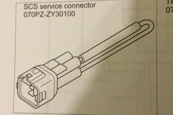

I've used that very plug with full diagnostic software on my own PCX. It was a third party diagnostic suite, but Honda has their own as well. As for the Jumper, the manual lists it as SCS device connector. See pic.homie wrote:LOL.. I don't think so, but I wish they would allow for user interface with full diagnostic software.
The jumper causes a light on the dash to blink in a pattern, which corresponds to a code. It's a little obtuse, but it works.

Ah yes.... the little jumper that gives you a morse code like sequence for general diagnosis on the road. These are small, handy and very portable. I keep one on board, so where do you get one for the Honda?

I thought the ECU gave the codes on the dash whether the device is plugged in or not? Some people report problems with their bikes and the dash light flashing short / long flashes. So, this port is needed for general 'mil code alerting'?

The dash light signals general fault, but the mil code is blinked by the diagnostics sequence initiated by the plug. It also enables clearing the codes.iceman wrote:I thought the ECU gave the codes on the dash whether the device is plugged in or not? Some people report problems with their bikes and the dash light flashing short / long flashes. So, this port is needed for general 'mil code alerting'?
A Scantool has more diagnostic possibilities though - so one can monitor all kinds of parameters measured and provided by the ecu, not just the fault codes.

Yep, that's the one. Punch in that part number and you can get one off partzilla.homie wrote:Ah yes.... the little jumper that gives you a morse code like sequence for general diagnosis on the road. These are small, handy and very portable. I keep one on board, so where do you get one for the Honda?
http://www.partzilla.com/parts/detail/h ... oCOC3w_wcB
As far as the software goes and computer cable goes, they had it at the school I attended. I don't remember who made it, but I can probably find out.

Not sure if that's just a wire, resistor or diode wrapped up in a candy shellhonkerman wrote:Yep, that's the one. Punch in that part number and you can get one off partzilla. http://www.partzilla.com/parts/detail/h ... oCOC3w_wcB

Just a wire. Lol.iceman wrote:Not sure if that's just a wire, resistor or diode wrapped up in a candy shellhonkerman wrote:Yep, that's the one. Punch in that part number and you can get one off partzilla. http://www.partzilla.com/parts/detail/h ... oCOC3w_wcB
