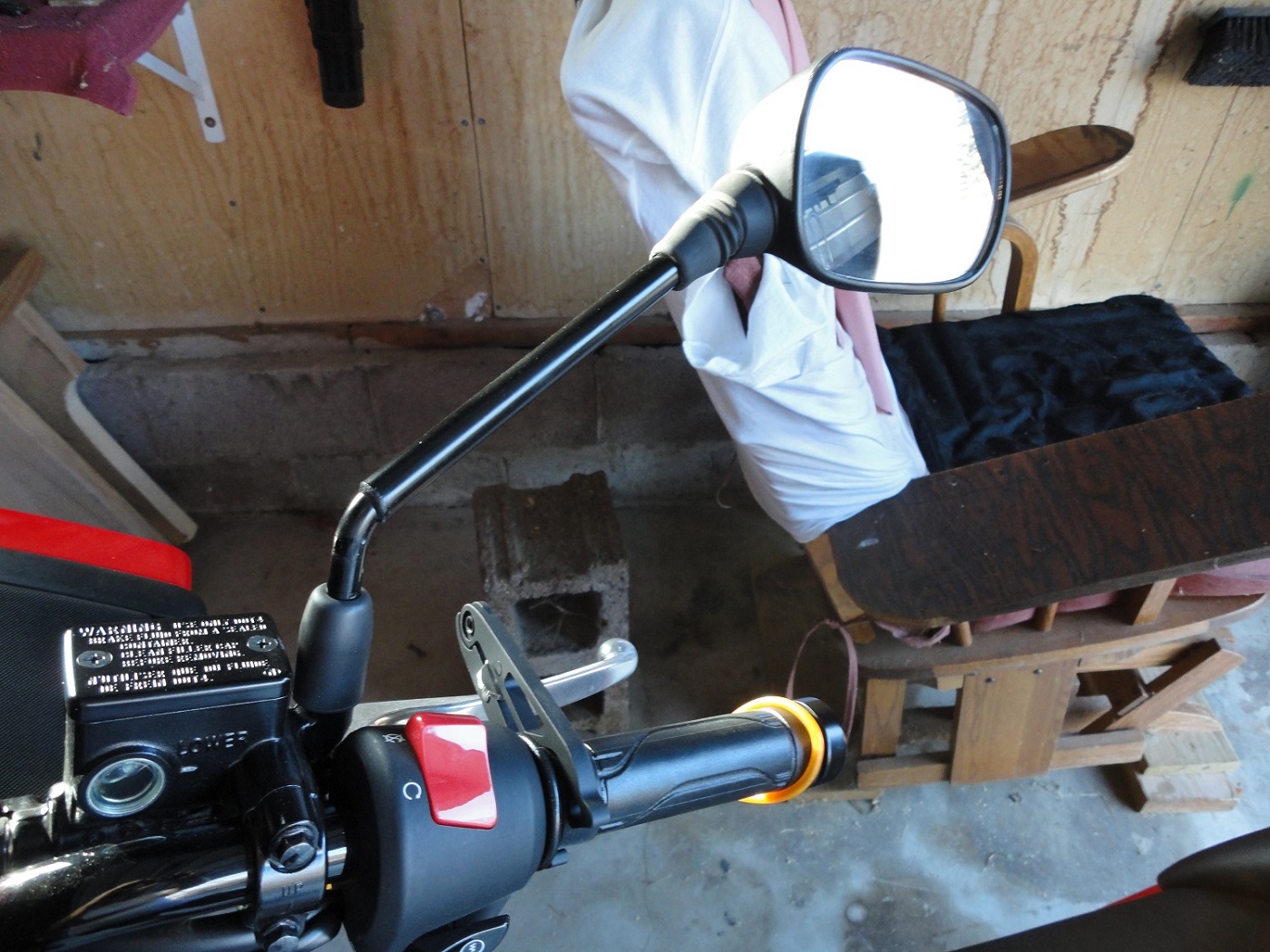

here was my solution that works extremely well and was dirt cheap
Re: Mirror extensions
Road-Dog wrote:here was my solution that works extremely well and was dirt cheap
What was is it?
What was is it?
He cut the mirror arms, cut a piece of aluminum tubing, slid both parts of the mirrors into the tubes, added epoxy and some paint. Note the ridge near the bend above where the mirror screws into its mounting hole.
