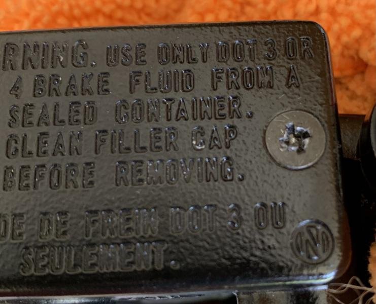

Today I tried to change my own brake fluid on my 2016 PCX150 for the first time and I cannot for the life of me remove one of the screws on the reservoir cap.
I used the correct size screwdriver, WD-40, rubber bands and a hammer on the screwdriver with zero luck. Has anyone had experience with a stubborn or stripped screw? What can I do here to remove it without damaging anything else?
Also, does anyone have a reliable site to order a new screw from? I found hondapartshouse.com, but I'm not sure if there's better sites out there. Thanks!

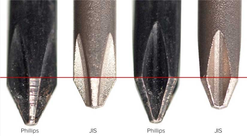

Re: Stuck Screw On Front Brake Master Cylinder
Also keep in mind that this bike uses JS head screws, not PhillIps Head. That makes a difference when the screw is stubborn.
Nice Tip (no pun intended)

Thanks all. I've ordered a JIS screwdriver with a few different tips for it and will leave it alone until it arrives. I don't want to strip it more than I already have. Will update when I try it.

Just got my JIS driver and it removed the screw no problem, even in this partially stripped state. Ordered a couple of extra screws to replace the current ones just in case.
