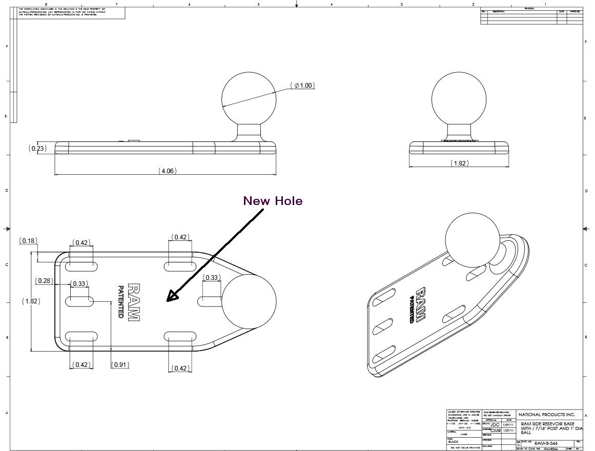

Did someone find a solution to mount a smartphone/GPS on the new Forza 300?
I am thinking of using the RAM-B-346U and Drill one extra hole.
Code: Select all
https://www.ram-mount.co.uk/reservoir-cover-base-with-1-ball-offset-mounted-p-1567.html?sesid=51fku112646ugt326e0h94flv4

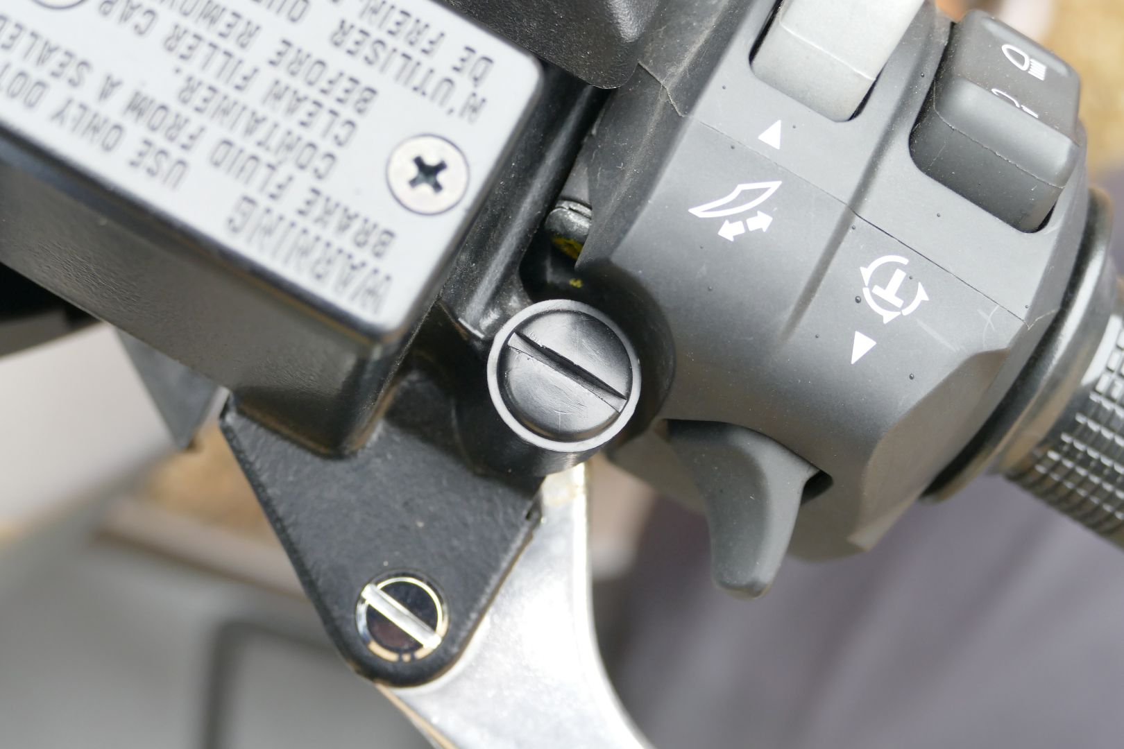

rollmops wrote:Where are the "false" mirror mounts ?? the one on the photo?
Looks the are made from Plastic.
Those are just dummy inserts. Remove them and you have a normal threaded hole to screw in your Ram..

There seems too be different threaded mounts..What is normal??
What I did was I took the plastic insert to the hardware store, tried out which nut fits it and then chose the screw that fits that nut.
The thread is really not "normal" but, what we call a "fine thread" and it is a right thread.
The new screw has to be a bit longer then the plastic one.

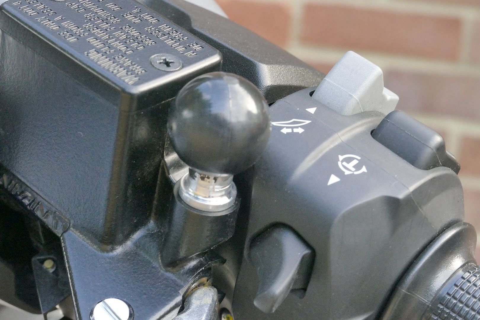

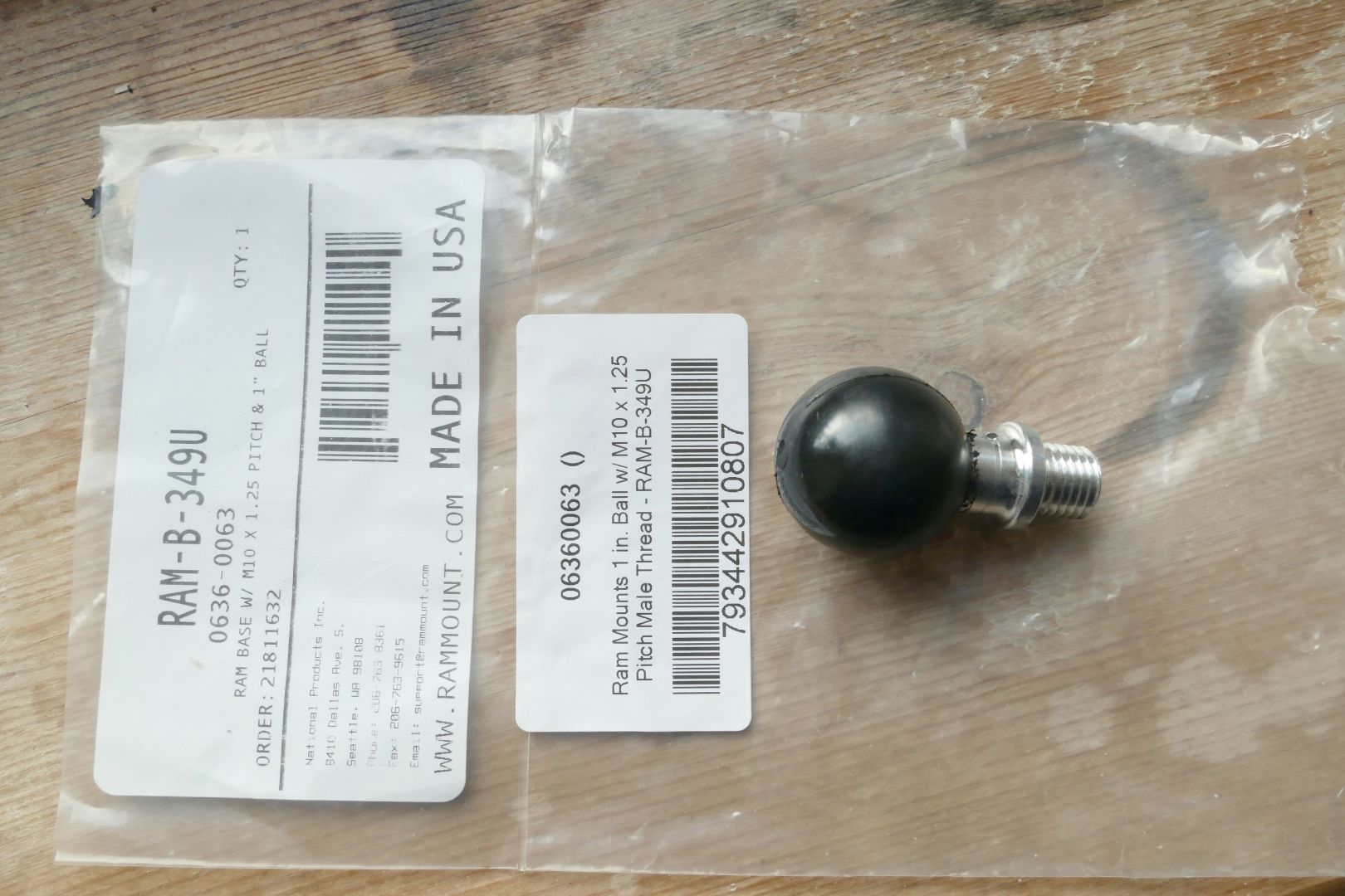

Received my ram mount today and it fits.
( RAM-B-349U )
However there is very little space left.The right side has more space.
Bit of a shame really because of the 12 v plug .

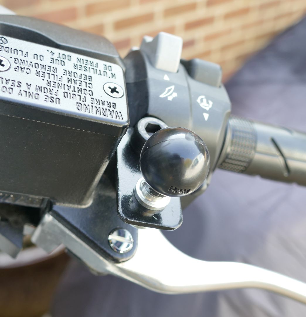

Posts: 1836
Year: 26 adv 160
Location: Fort lauderdale
Re: GPS Mount for new Forza 300??
Post by Jge64 »
Any machine shop can make you a 2 inch extension and collar out of stainless rod and thread it...;For probably less than 25 bucks.

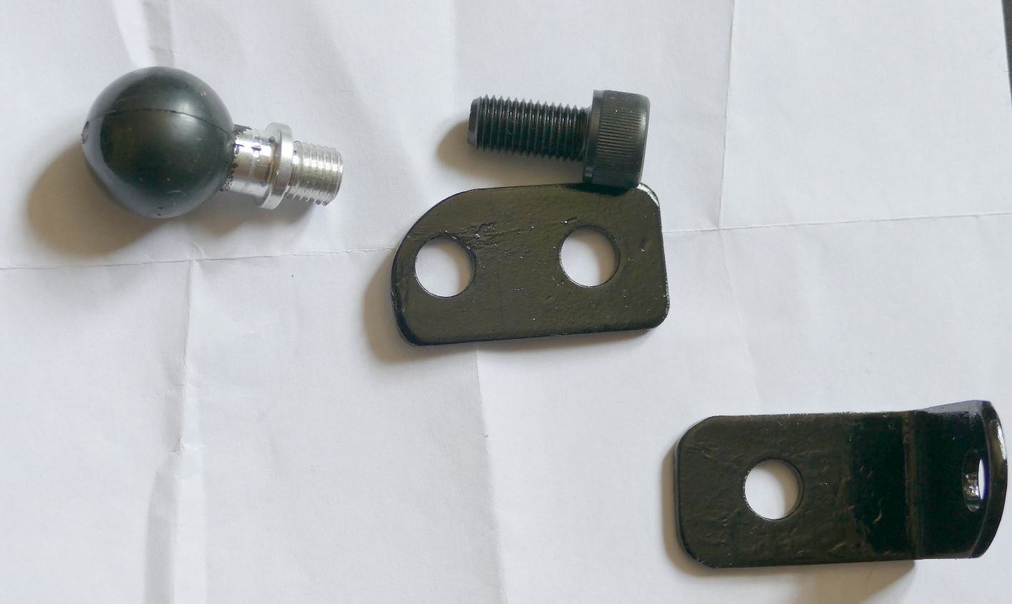

Post by rollmops »
I made 2 extention from aluminium too get the RAM Mount further away from the Breakfluid container.
