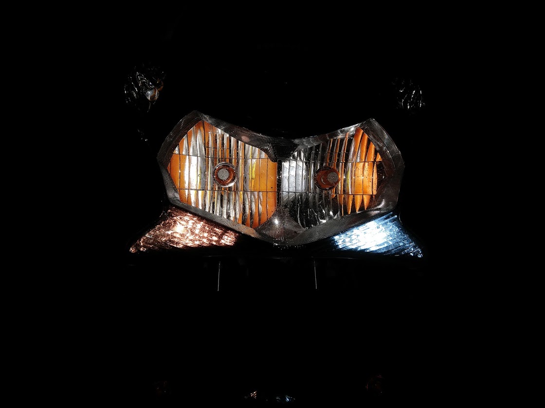

I retrofitted the EU light sockets on my 2013 Honda pcx by buying the EU headlight harness and drilling out the holes for the bulbs on the headlight housing. I had to use some hot glue on the running lights since they would fall out every now and then.
- IMG_20180130_024240155.jpg (88.43 KiB) Viewed 11184 times
- IMG_20180130_024023689.jpg (141.23 KiB) Viewed 11184 times

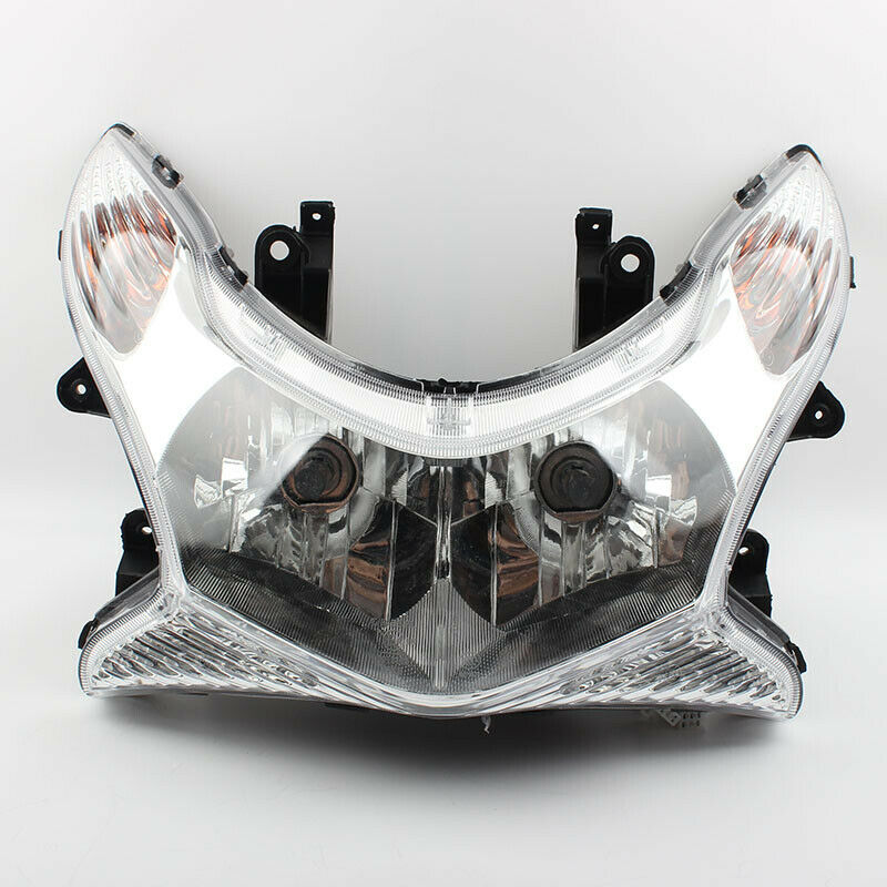

Look what I found. European headlamp 130.00
- ebay headlamp.jpg (96.6 KiB) Viewed 10831 times

Gil the bottom lights where did you tap to make them light up. I know the top are turn signals. Middle are headlamps. and Bottom are driving lights.

Re: Retrofitting to European Lighting
That's what the bottom ones are? Hmm...considering that the headlights come on automatically when the bike is started, why do we need those??
Never mind. I wired mine into the headlights anyway. It just seemed logical.

I did the same thing wired to low beam lights,Mel46 wrote:That's what the bottom ones are? Hmm...considering that the headlights come on automatically when the bike is started, why do we need those??

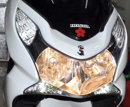

heres my pic of new headlight installed.
- headlight3.JPG (47.01 KiB) Viewed 10627 times
what's the reason that US model PCX have bunny ear indicators ( turn signals ) ?
- pcx888
- Posts: 175
- Joined: Sat Nov 25, 2017 9:31 pm
- Color: pearl white
- Location: Hacienda Heights, Cali
2011,2012,2013 model had to have bunny ear indicators. Due to bike being too narrow. By a couple of inches. So the rest of the world bikes didn't have them. Stupid regulations. and the start and stop switch.Yorkie150 wrote:what's the reason that US model PCX have bunny ear indicators ( turn signals ) ?

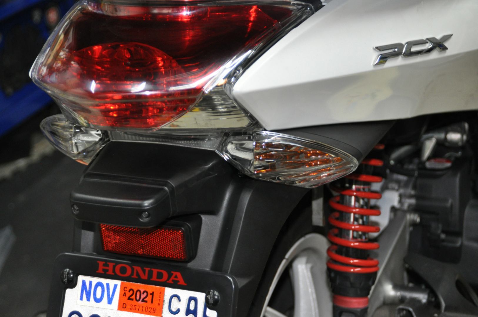

Heres pic of the completed project.
- TAILLIGHT COMPLETE_00001.jpg (221.83 KiB) Viewed 10560 times
Looks great

Late reply, but the second picture is of the driving lights. I just made the hole in the middle of the circle depression in the plastic. I did have to use hot glue otherwise the lights will fall out.pcx888 wrote:Gil the bottom lights where did you tap to make them light up. I know the top are turn signals. Middle are headlamps. and Bottom are driving lights.
