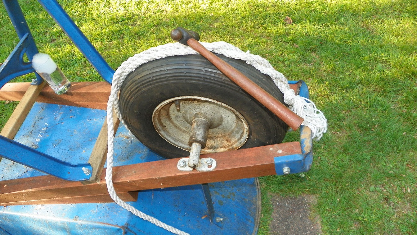

This pic shows the basic layout of the rope and hammer handle I used to tighten down on the tire and force the walls to seal against the rim. I basically tied an overhand knot somewhat firmly and then positioned the hammer handle inside another two half hitches knot. I started rotating the hammer handle, keeping the rope in line on the wheel, and tightened until the walls were against the rim. :o

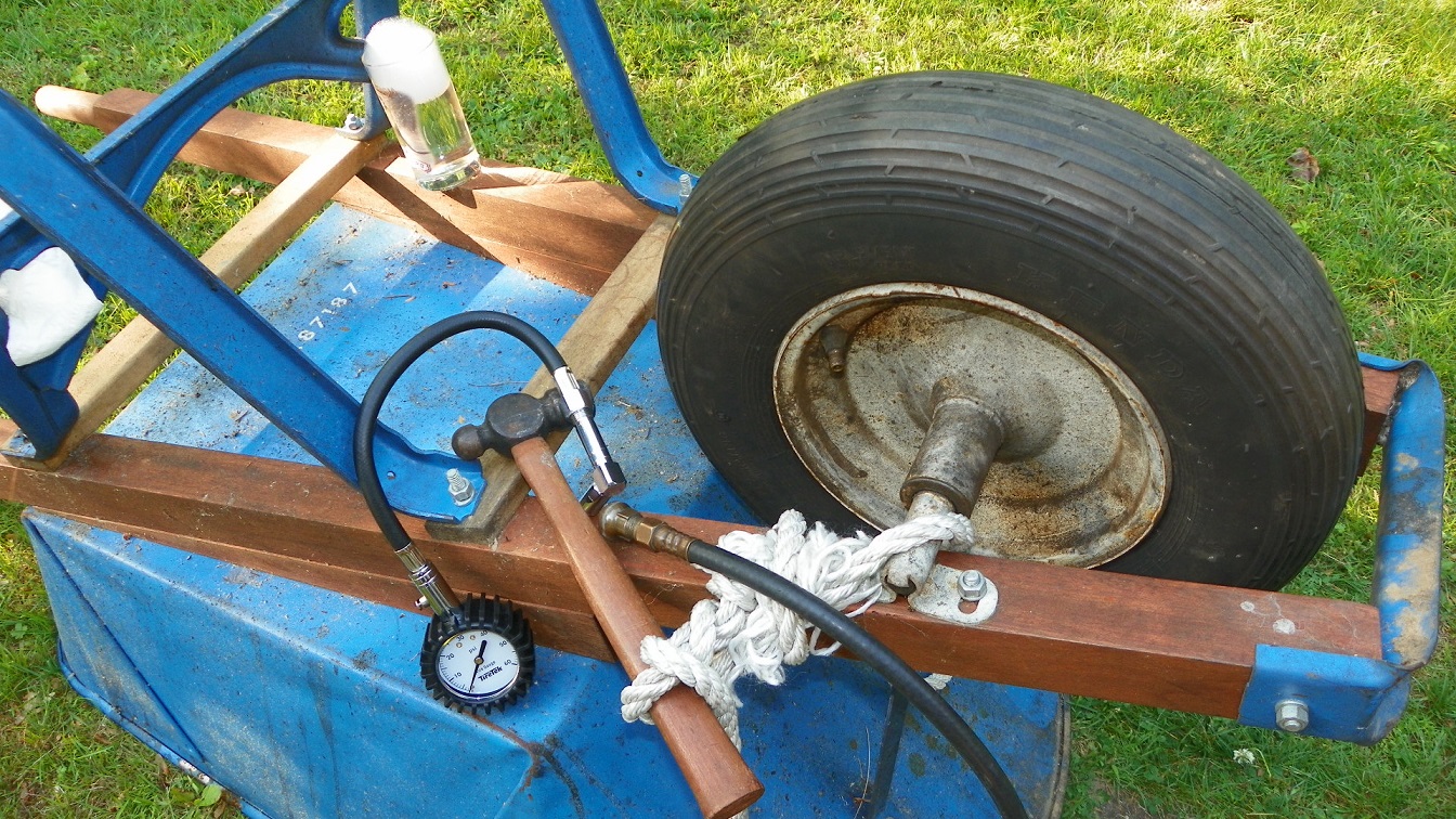

Next, you will see the tire is now inflated. When I was adding air from my compressor line I gradually released the tourniquet pressure slowly and let the tire return to it's normal inflated condition. The compressor was set to 30 PSI and I used my tire gauge to set the tire pressure at 24 PSI. . . adequate for practical use. 8)

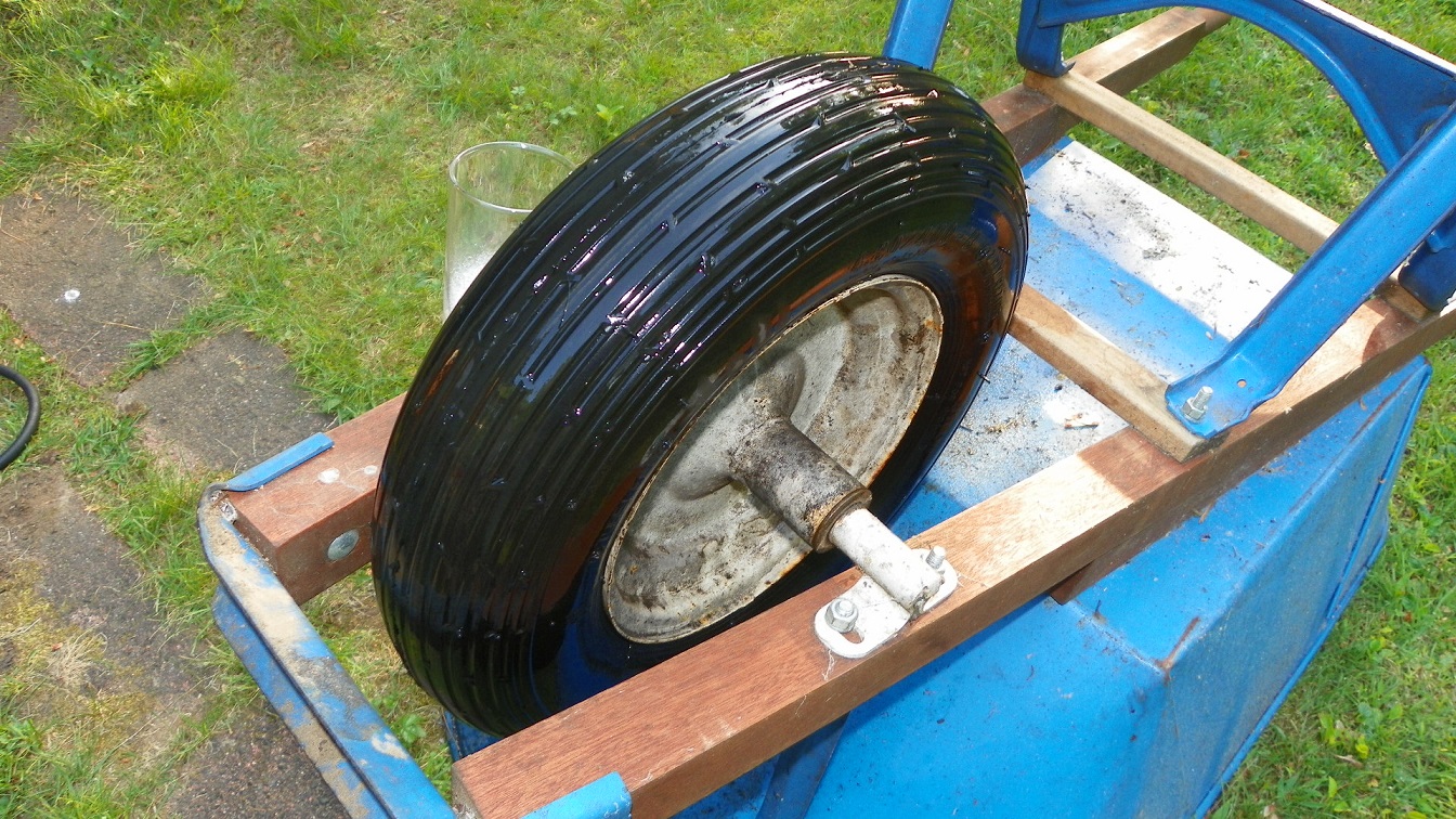

Finally, since the tire is really old and showing some dry cracking, I added a dish soap and water solution to see if I could detect any apparent bubbles from leaks. It was fine. Rather proud that I just saved myself some money and will kick this can down the road another few miles. . .. :D
