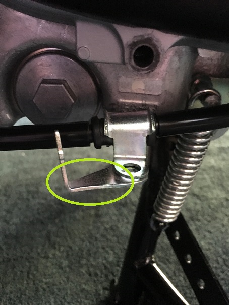

So idiot that I am when I went to use my torque wrench I discovered that it starts at 20 ft. lbs. and goes up from there. It's more of a heavy duty automotive type one. I'll have to pick one up that deals with the lower torque values. :o
That being said I kind of went with my instincts from working on metric bikes over the years and carefully tightened the oil drain plug, the brake cable bracket bolt, and the strainer cap. I will say the strainer cap did give some resistance on removal and I used the leverage of the torque wrench handle as a persuader to finally get it to spin. . .and without rounding anything off. You were absolutely right about the fuzz. And it cleverly tucks itself up near the rubber piece the screening is molded into as well. There was some "greyish" graphite looking material that came off on the paper towel when I cleaned off the screen. . .not particles. . .just very fine pencil lead colored stain. I thoroughly cleaned off the screen needless to say and reinstalled with the 17mm socket. Not really any compression room there. Once you get the screen, spring, and cap assembly spun to the mating surface it's hardly a twist after that and it's on tight. I did put a little new oil on that cap o-ring before reinstalling. 8)
As an added note I made sure the brake cable was properly routed and not out of plan when I reinstalled. ;)
The SM said replace 1 quart of the recommended oil if you drain the oil and remove the strainer. . .which I did. I found the level to be a little bit higher though than the high level mark on the stick upon measuring it after running the motor for a bit. I definitely got at least 800 ml of old oil out of the oil drain pan (poured it back into the empty Honda oil bottle) and there was some residual still in it. So by adding the quart I know it couldn't be that much more than what came out. Seems like a vague situation. :roll:
Here's what I did when I drained the oil. . .unconventional and don't recommend it to others but I walk the edge sometimes. The motor was warm and the exhaust pipe was warm. Not hot enough to burn me but close. I have a plastic triangular oil drain pan. I put the PCX on the side stand. I removed the oil filler cap, cleaned it and put it aside (the o-ring was fine). I loosened the oil drain plug with my 12mm socket wrench just enough to loosen it by hand without oil coming out yet. I carefully fit the one of the angular ends of the oil pan under the PCX in such a way that when I was loosening the drain plug by hand the oil spilled right into the pan and on nothing else. Then wiped off my hand and the oil plug/washer to reinstall later. When the draining stopped I went around to the kickstand side of the PCX and while carefully holding the left handlebar and passenger grab rail I let the PCX lean to the starboard side and could hear more oil coming out. I did that until it stopped. . .did it again. . .heard it a gain. . .and did it one more time until it had definitely stopped. I proceeded to wipe off the drain hole and hand tighten the plug before I pulled out the drain pan. Then I tightened the drain plug carefully with the socket wrench. Note that since the oil drain pan was plastic it could "give" a little bit if there was contact with the frame or exhaust pipe etc. . .when I lean it over. :geek:
Next thing I did was put the PCX on the center stand and got ready to remove the brake cable bracket bolt and the strainer cap. The 8mm bracket bolt came off easy and I just tugged down on the cable a little to allow more access to remove the strainer cap. I then slid the oil pan back under the PCX strainer cap penetration. Using my 17mm socket with the extension I first had trouble trying to loosen the cap. So I tried using my torque wrench (much longer handle) with the socket adapter and low and behold the cap let go and I was then able to hand loosen the assembly. As stated above I found the "fuzz" and some other stuff. There also seemed to be some red paint that was applied along the lip of the cap like a factory reference mark or something. While the strainer assembly was removed (and with the PCX still on the center stand) I again carefully grabbed the left handlebar and passenger grab rail and tilted the PCX towards me a bit (to the port side) and could hear more oil pour out. I repeated the effort a couple of times to allow things to settle in the base of the motor and to enhance the amount of oil removed as much as I could. The next time I do this I may take it off the center stand first and then do the tilt. . .but like I said sometimes I live on the "edge". :lol:
So after 612 miles my PCX is running great with fresh oil and a clean screen. I hope being a little over the high oil level mark on the stick isn't a mortal sin. If I have to I can drain a little out but it seems OK. Will think about. . .. :geek:

Okay. . .so I thought it over and I'm going to drain enough oil out to meet the "full" level on the dip stick with the engine warm.
What did I learn from this? You can't always believe what you see. . .. Although the SM says to add 1 US quart of oil (ref. SM page 3-12), if you drain out the old oil and remove the strainer, it isn't necessarily true to the letter. Some oil will remain in passages etc.. . . .within the cavities and void spaces of the engine. . . and so when you add oil during an oil change it's best to add most of it. . .say around 700 ml at first. Then check the dipstick and see what that indicates. If it's below the "full" level then perhaps add a little more or if it's close to "full" it would be OK to leave it "as-is". That being said do the occasional oil level checks and add as needed moving forward as mileage accumulates. :geek:
Even though I did tilt the PCX to help oil find it's way to the drain hole and strainer penetration it just wasn't enough to remove 100% of the oil in the engine. As stated previously I was able to get about 800 ml of the old oil out of the engine. . .which basically is the recommended amount to add on a routine drain and fill operation. ;)
