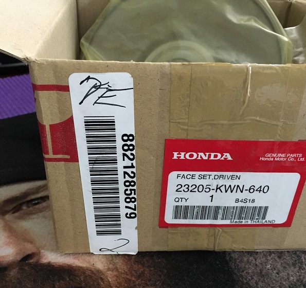

could it need any more parts then these http://www.cheapcycleparts.com/oemparts ... set-driven

That's it, I keep one on hand just in case but obviously not all are bad or going bad. There's a new part number for after 13's and it hasn't been established yet if the old part# fits newer PCX. I think you can get 1200.00 There was once a guy who offered one for 800 but he looks crazy
Never saw one that low.
- unnamed.jpg (122.06 KiB) Viewed 1850 times
