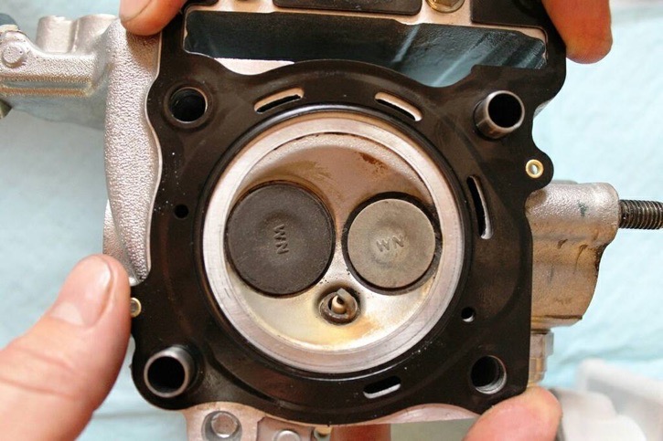

I have 164 yuminashi kit with stock exhaust and it overheats. But it overheats with aftermarket one from webike as well so it's not exhaust fault. I wish I have cut bigger holes in head gasket water ports when I put it on. Too late now. If I have to take the engine apart again I will put 150 head conversion from yuminashi.

Go ahead and get it. It's well worth the money. I have overheating problems with mine but it's head gasket alignment rather than stock exhaust fault.

It overheats on WOT if revs go higher when accelerate downhill. It doesn't overheat in traffic or in hot weather. 164 kit does everything on 1/3 throttle that stock would on WOT.

Don't know. It took me two days and few beers. I'm amateur and it's taken more time to take plastics off than actual engine work. Have a go yourself and you might learn something. Great tutorial here on forum from Maddiedog. You'll be happy with the results. Image
