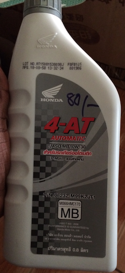

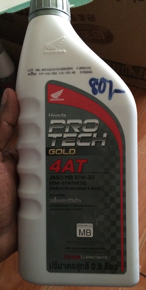

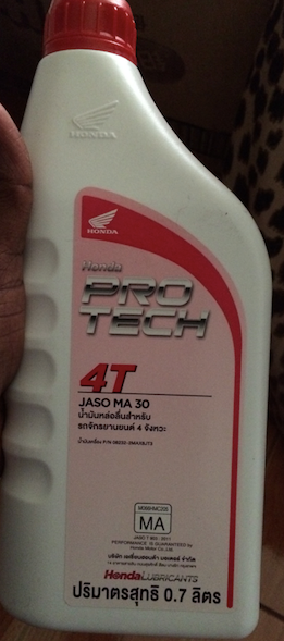

Which engine oil suits for pcx 150 for the first oil change.
I have the following types available in a local shop. Which one should I choose for the initial oil change at 1000km.

Re: Which engine oil suits for pcx 150 for the first oil cha
Mobil 1 10-w30 synthetic
I don't know if that answered your question, but the two most important parts of his answer were 10w30, and full synthetic. Because it does not have a wet clutch I don't know that the MA vs MB will make much difference, though I would go with MB because it is recommended.
The top bottle is just SAE30 constant viscosity (for lawn mowers, etc), so you can rule that one out. Either of the other two would work fine.
Hi suzxee1234,
Out of those three choices, the Pro Tech Gold 4AT (MB 10W-30 semi-syn) is the best oil for your PCX.
However, if you have access to full syn motor, that would be even better oil for (probably) less money.
An xW-40 or xW-50 weight oil will provide better protection than an xW-30 oil.
Thank you all for the help.
I will go with the semi-senthetic option then.
