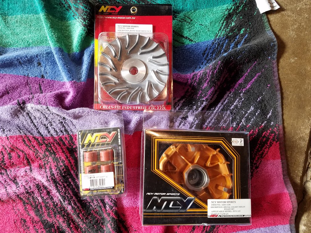

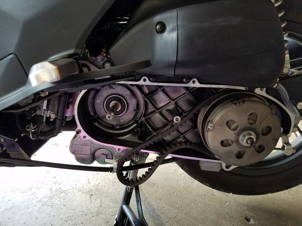

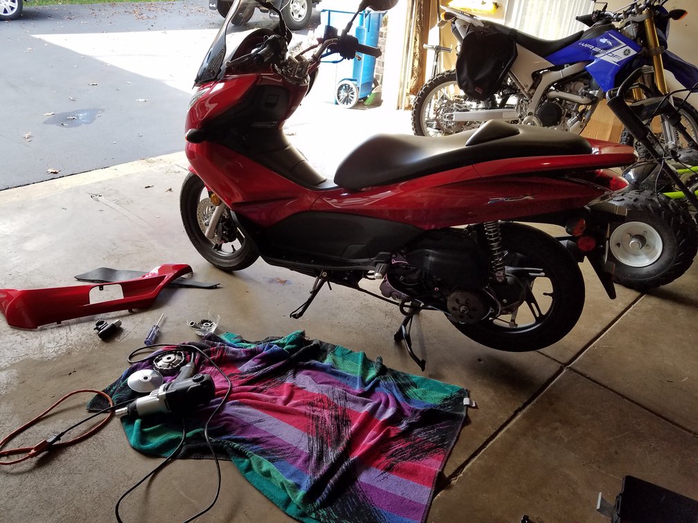

I installed my NCY variator, drive face and 13g rollers today!
Works good. Very peppy. Holeshots are fun! Gained maybe 2 mph so far. May need some break in time?

You updated everything except the belt, so how many miles were on that Belt? If it had more than 3,000 miles it will start losing speed from wear. You should have changed both the variator set and the belt if you had any miles on that belt. The clogged belt is a new innovation on the market. I think Homie had ordered one and was going to give us a report on it. Maybe I missed the report.

My bike/belt has just over 1050 miles on it. It probably is stretched out a little bit.Mel46 wrote:You updated everything except the belt, so how many miles were on that Belt? If it had more than 3,000 miles it will start losing speed from wear. You should have changed both the variator set and the belt if you had any miles on that belt. The clogged belt is a new innovation on the market. I think Homie had ordered one and was going to give us a report on it. Maybe I missed the report.

My acceleration seems pretty good now with the new variator, but my top end seems the same as it was. I am sure you will probably smoke me.homie wrote: Roosevelt to Butterfield on 355 works too. Toll gate never registers my transponder but if your plates are properly listed on I-pass website they credit you from the picture and I haven't been ticketed yet
The new belt is slowing me down right now, guess it needs to break in. You have the faster drive train over all with a 2011 but 125cc vs 2015/150 will be interesting. I had great down hill top end with 4k on my old cogged belt but we will be on the flats... so real world PCX speed ma man

Give your new setup time to seat. I believe that it is just now starting to like the new setup. When I changed out ours it didn't have any improvement or a few days, and suddenly it just wanted to run....and it ran quite well then.

Hi Mel, yes, I think it did need a few days for my belt to run in to the new components.Mel46 wrote:Give your new setup time to seat. I believe that it is just now starting to like the new setup. When I changed out ours it didn't have any improvement or a few days, and suddenly it just wanted to run....and it ran quite well then.

How much did the parts cost? I love my bike to bits just an extra little is all i ask.
Tipover
- Posts: 45
- Joined: Sun Oct 23, 2016 10:05 am
- Color: Candy red
- Location: West suburb of Chicago
Re: Aftermarket variator setup on 125
I purchased from Corsport. Total was 110 dollars. Plus, I had to buy a 22mm socket from the store. I borrowed a friend's electric impact wrench to do the job.87112 wrote:How much did the parts cost? I love my bike to bits just an extra little is all i ask.

Be sure to use the 13gram rollers with that kit. We have tried others and 13 is the ticket. Impact wrenches are not costly at all, I think mine is from harbor freight. You can use it for removing the nut but not to tighten, you need a torque wrench to do that so factor another 100.00 for a couple cheap wrenches if you can't barrow.87112 wrote:How much did the parts cost? I love my bike to bits just an extra little is all i ask.
http://www.corsportusa.com/2010-honda-p ... on-pulley/
http://www.corsportusa.com/2010-honda-p ... rive-face/
http://www.corsportusa.com/2010-honda-p ... ights-13g/
Pay no attention to the 125cc or year... it's the same kit, but you should check for updates anyway from this supplier.
