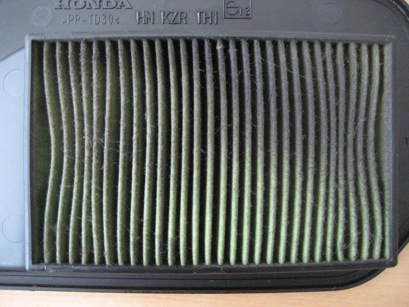

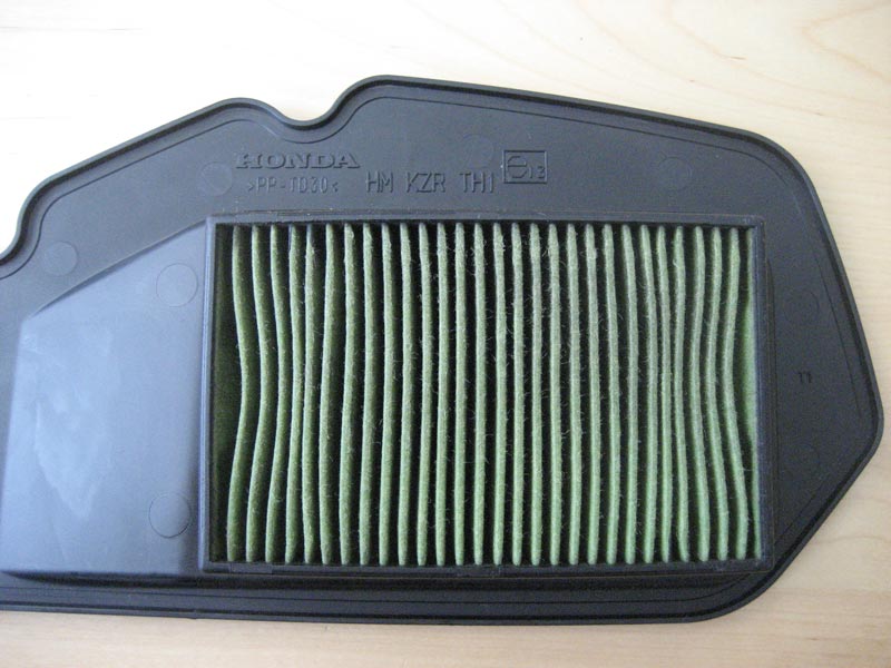

Hello everybody.
My PCX 2012 eSP has only 5500km on the tacho. I have open the air filter housing and was supprised that the air filter pretty dirty and oily was... I´ve cleaned it a bit, but would you still replace it?
P.S.
On the filter is written HM KZR TH1. It´s not the actual part number (17210-KZR-600), what is this number???
Thanks
after the cleaning
after the cleaning
before
before

Nope. Lotta life left in it.
Re: Would you replace this air filter?
Its supposed to be oily, a new one out the packet is oily.
Your filter is probably good for another 15,000km or more.

Thanks for the help :D , I was missing a "reference" of what dirty air filter is. Maybe someone has a photo? :roll:
I cleaned it with a good vacuum cleaner, but only from the "dirty"- green side.
