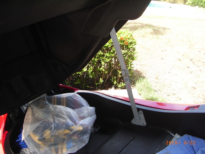

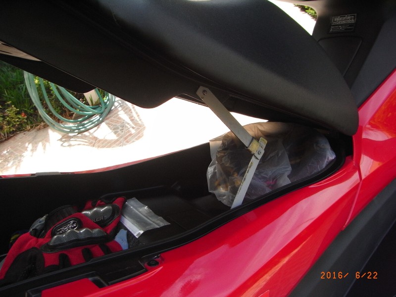

Hello this is my solution of the broken opener damper and it works good

when is fully closed it seems that it will hit the helmet if you put it in the lower position? above the battery?
i ask this because the storage widens where the helmet sits and it seems to me that is going to interfere?
if it doesn't hit the helmet great!
i might be coping your solution:)

Hello eidikos I was just and test I have shoei raid2 if I take to the left said it close but it works

Nice work, Affeno!
Did you make that yourself? What was it used for originally?
Love it,
Johnny

so affeno, is it diy or did you purchase it from somewhere?

Hello yes I made it by myself but I think you can buy similar at a hardware store as the picture, it is used for windows or furniture

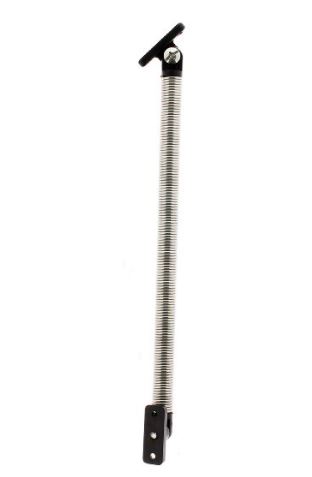

While I am currently using "Stick" technology, I have also considered misusing a bit of boating hardware. These hatch springs are used to keep the lid of a nav station up. When you lift the lid, the spring becomes rigid. To close, you push on the side of the spring and it collapses.

GeorgeSK wrote:While I am currently using "Stick" technology, I have also considered misusing a bit of boating hardware. These hatch springs are used to keep the lid of a nav station up. When you lift the lid, the spring becomes rigid. To close, you push on the side of the spring and it collapses.
https://www.amazon.com/dp/B004XAE4B4/re ... EDHDC5RG3J
@GeorgeSK this is, in my opinion, a better choice than the one from affeno and i will explain why i think that.
on saturday i went with my wife on a trip with the motorcycle club we are registered in. in the compartment under the seat we had her purse, her jacket and my jacket. we put her stuff in the compartment where the battery is but my jacket wouldn't fit in the top compartment. so i had to lay it so part of it was under the thin space that connects the two.
As it turned out it was too hot to wear the jacket so it stayed there for the whole trip. During the trip i opened the seat 3 or 4 times.
Affeno's solution would most probably catch the jacket and maybe damage it also, but GeorgeSK's solution because its a flexible spring and not rigid aluminium wont catch the jacket but adjust its shape upon closure.
