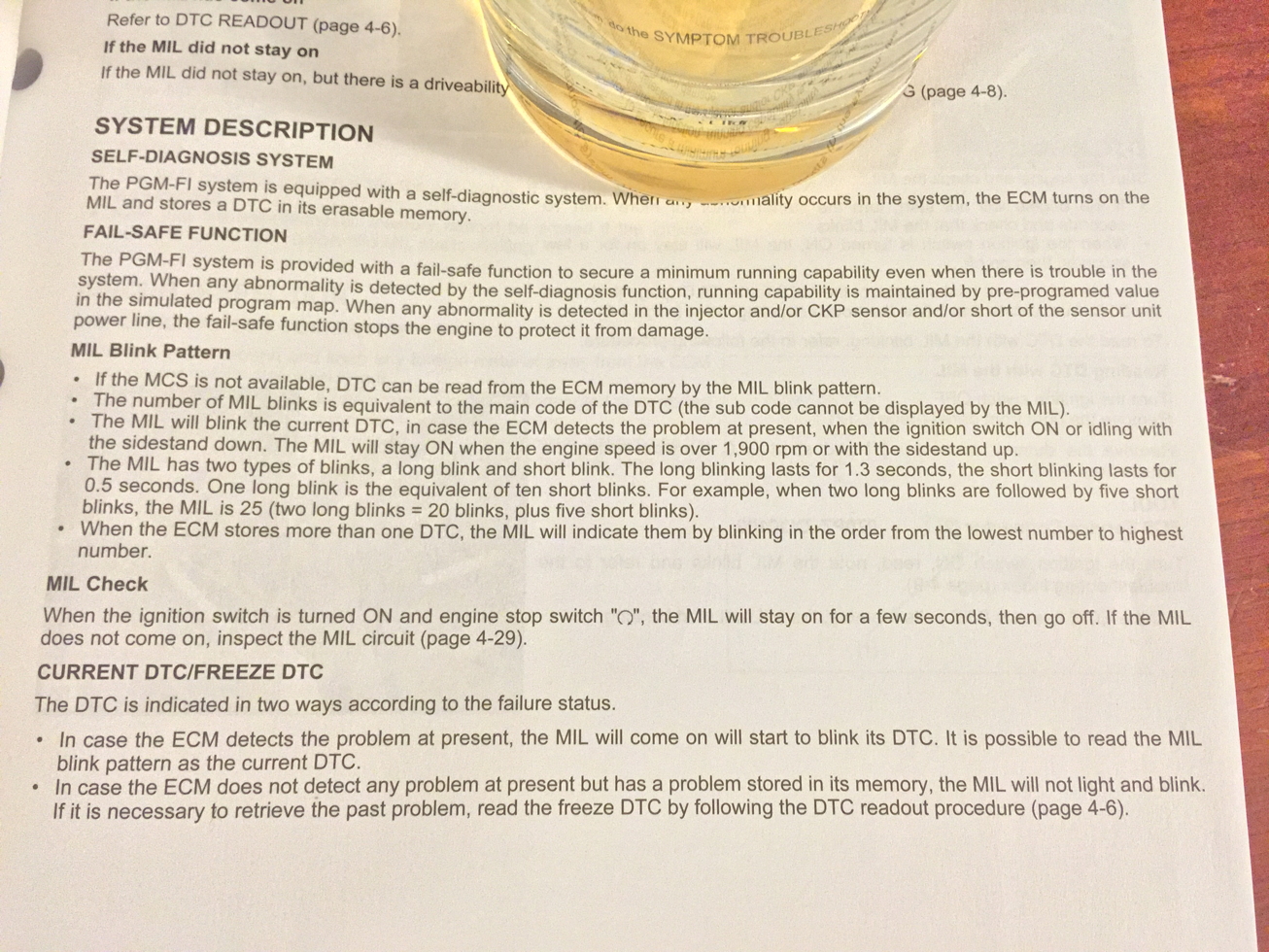

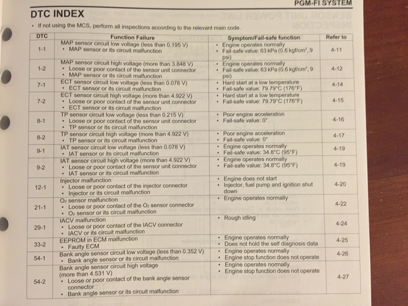

OK, here are inadequate cell phone pictures of the relevant pages from the 2014-2015 Service Manual
First, a list of the codes.
Then, the description of system the bike uses to report trouble.
(I uploaded those pictures in a different order, but this is the order the board want us to have them in.)
- Forza blink codes sm.jpg (988.64 KiB) Viewed 14246 times
- Forza blink description sm.jpg (1.09 MiB) Viewed 14246 times

So looking at the codes it's showing a fault with the bank angle sensor then.
Sent from my iPad using Tapatalk

I have to comment that that is just brilliant...
I read those pages and hadn't a clue what they were about!!...but now I know...and once you understand its easy really!
great forum this.
great forum this.
