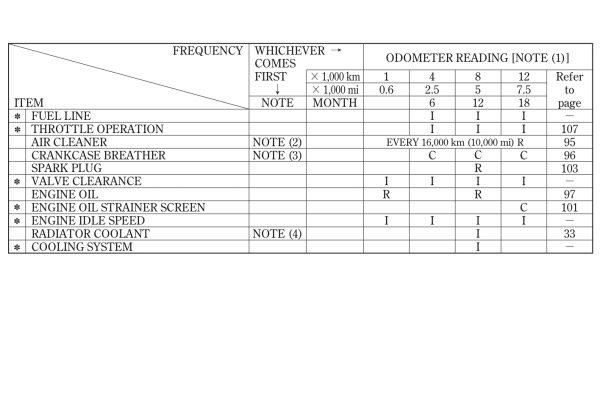

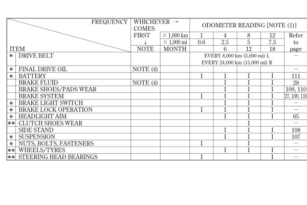

Did you not get an owners manual? All the service info is in there. It's 600 miles then every 5000 miles. Although old you can grab a manual from here:iyernat wrote:Hello
Thx for your reply.
I have seen your oil-change youtube which is what has inspired me to this project myself.
Can you please post a transmission oil change youtube as well if you have one.
Lastly - I bought the scooter used at 2000 miles. The prior owner did do the 600mile service somewhere in Vermont. I have put 1000 miles over a year. I was wondering about the frequency of engine/transmission oil change I should perform.
Thanks for your advice.
http://www.hondampe.com.au/docs/owning_ ... 5_2011.pdf
Most of the info for service still applies.
- honkerman
- Posts: 1220
- Location: Pennsylvania, USA
Re: Transmission oil
Well, according to the owner's manual, the engine oil should be changed at 600 miles (first service which you say was done), then every 5,000 miles after that (see attached pictures). There is no mileage recommendation for the drive oil, it just says to change it every two years
