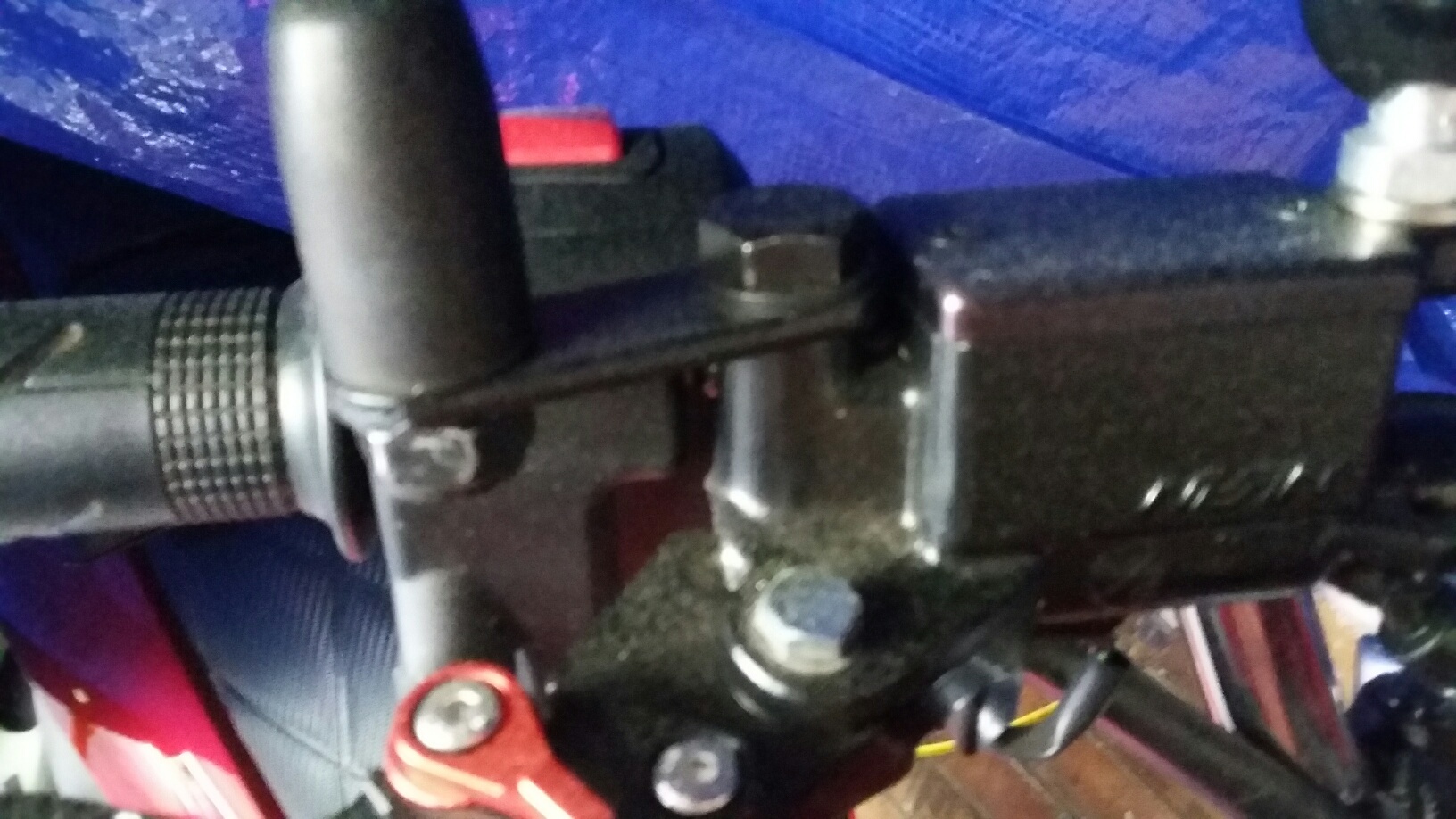

I finally found the extenders.
So I went out to try moving the bars back and discovered that the bolts are hex pin bolts and a regular 6mm hex wrench won't go in the hole correctly.
So I have to go spend more money on tools I will use very rarely. :(
And have mirrors hitting the windshield in the meantime.

I don't know if I'm seeing things or not. In different light and at different angles, the hex bolts for the handlebars look different.
Are they, or are they not hex pin/pin hex bolts?

Success, finally. I had to use a hammer to tap the Allen wrench into the holes, and tap on the wrench to get it to turn to loosen the handlebar bolts. I rotated them back maybe 1" or less. Then rotated the brake levers down a bit to a comfortable position. Now the mirrors barely touch the windshield when I turn hard, as in slowly turning around with my feet down.

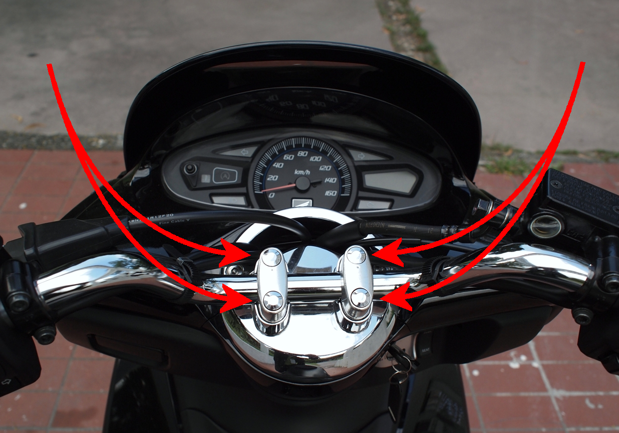

I'm not 100% sure that I follow how to do this. I looked at the handlebar mount yesterday, and I don't see any way to attach any kind of wrench to it. There's four smooth bosses where bolts should be. It looks like I'm going to have to take all the plastic body parts off the front to get underneath to find a bolt head.
Anyone have any kind of diagram to show how to rotate the handlebars? Could they please post it if they do?

Re: Mirrors hitting windshield
This is getting crazier!
Hey Ish, do us a favor...can ya post a pic or two of "what you're looking at?" In reference to your bars 4 smooth bosses/bolts and whatever else you're having a problem with. I/we need a close look too ;)

WhiteNoise wrote:This is getting crazier!
Thanks!
I'd love to, but the bike is still in my friend's garage across town. I haven't yet gone to get a motorcycle endorsement for my driver's license.
On second thought, I've found a pic online to show what it is to which I refer. The red arrows point to the bosses on the handlebar mount.
