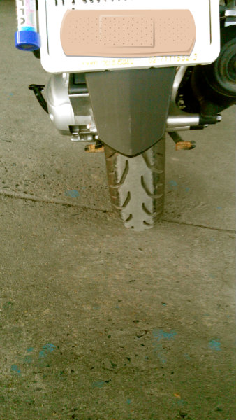

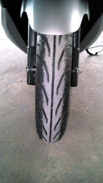

The recommended tire pressure seemed a bit low to me, due to the amount of weight my PCX carries (me at 110 kg, my son at 35 kg, and 10 kg of gear). The contact patch ran all the way to the side grooves. I upped the pressure a bit and I think I have a good contact patch. Please, opinions and advice are welcome if I have it wrong!

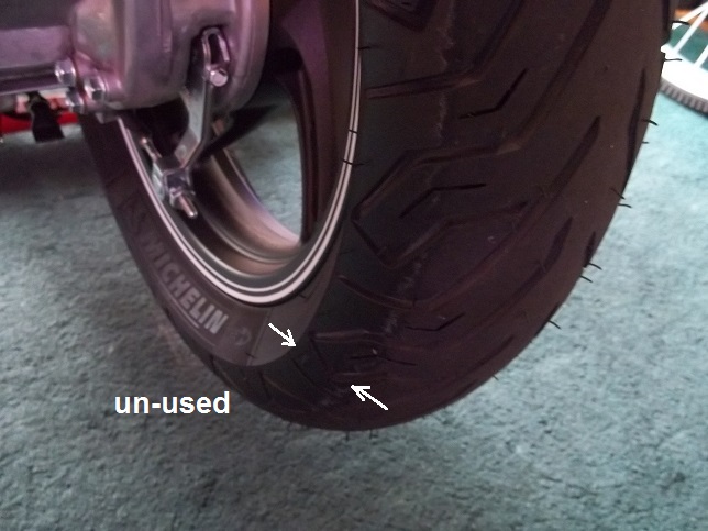

I backed off the recommended pressure about 3 pounds with the larger Michelin's for comfort and grip. This photo was taken at a point I had just leaned into a turn and scraped the ground to see how much tire is never used and does not reflect what you are showing... straight and level on a chalky road?
I might have to try that to see where I'm at with rubber contact 3-4 pounds under.

Ya, I am straight and level and fully loaded. Actually, it's cement dust LOL And I have not backed off. It is upped a bit (41 lbs rear, 38 lbs front).
Re: Tire contact with the road
41 rear 33 front is the recommended for mine. Currently lowered to 38 rear 29 front.
You want to match your surface contact to a tread pattern? With all the patterns available I had not heard of this as a consideration for tire wear control. When I was high and tight I benched mine for performance but then backed down the air pressure because I was not feeling safe in the turns given a little gravel or other seasonal debris one might encounter. Please don't join the survivors list with hard slippery tires
