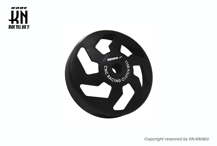

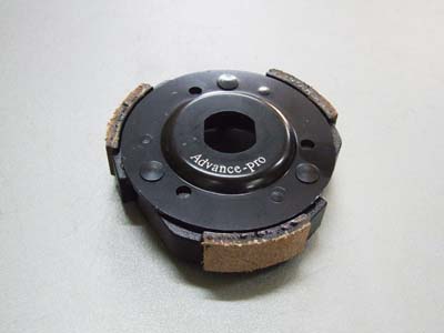

hi, had any one ever use this parts?

If anyone, talk to Pcxdemon about clutches.

What's the advantage?

The bell is about 200g lighter than any other bell on the market...on mine when it's installed I feel like I get a instant shove from behind kinda response when I wot at midrange, I just couldn't replicate that with normal weight bell, so I have to say there is something positive in it..
With clutches wise, you could just easily buy stiffer springs and it'll most likely have very same performance as an aftermarket clutch..

Ive been using this bell for a couple of weeks now and i have to say its ok but only for track racing. Top end speeds will drop due to torque loss and also i felt hill climbing speeds were dropping to fast as well.
For everyday rider its not really worth it.
