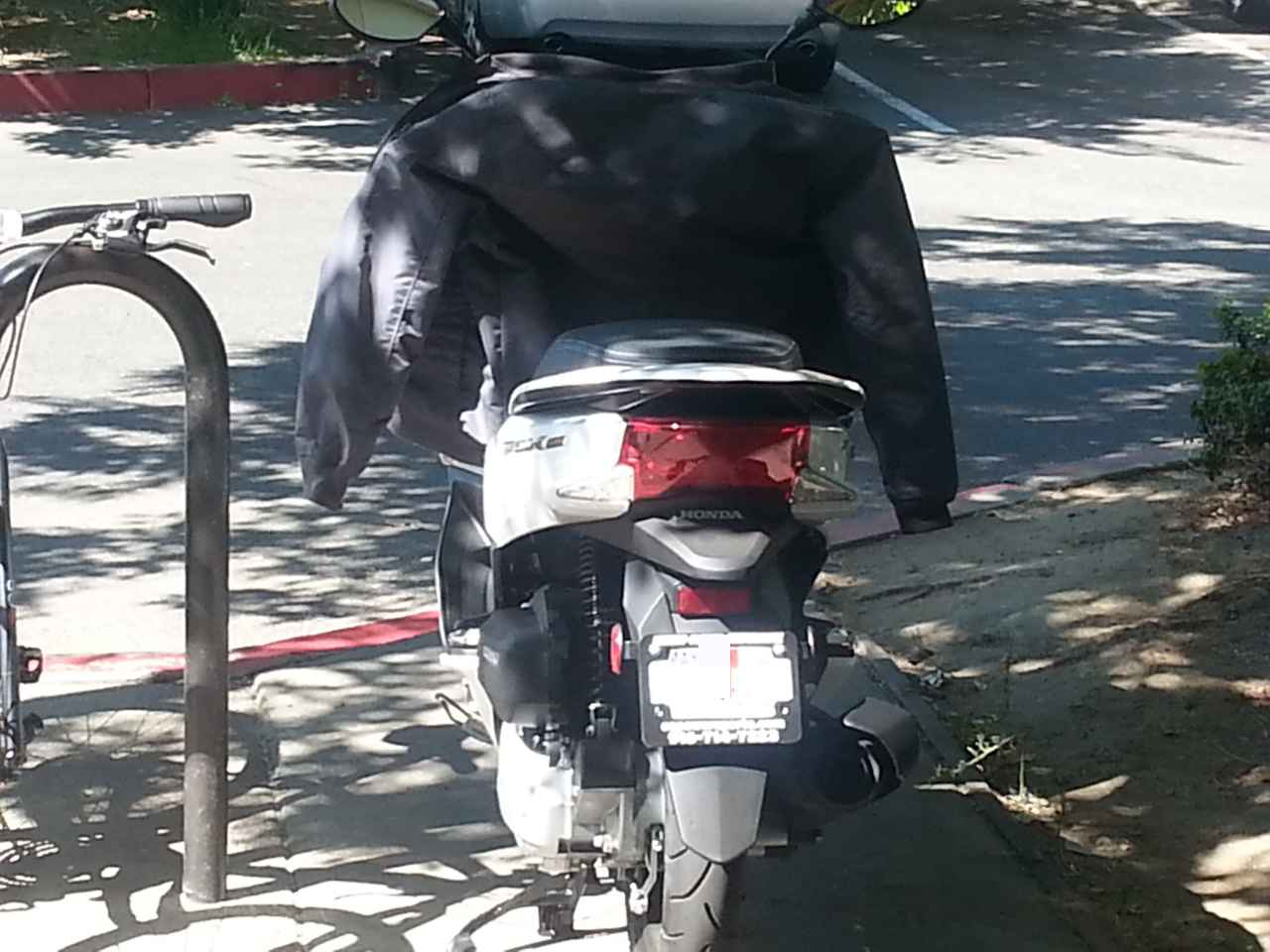

Re: Embarrasing: Clock adjustment
Thank you guys, I was too lazy to read the manual but holding the button down waiting 5 seconds and pushing the button again worked.
