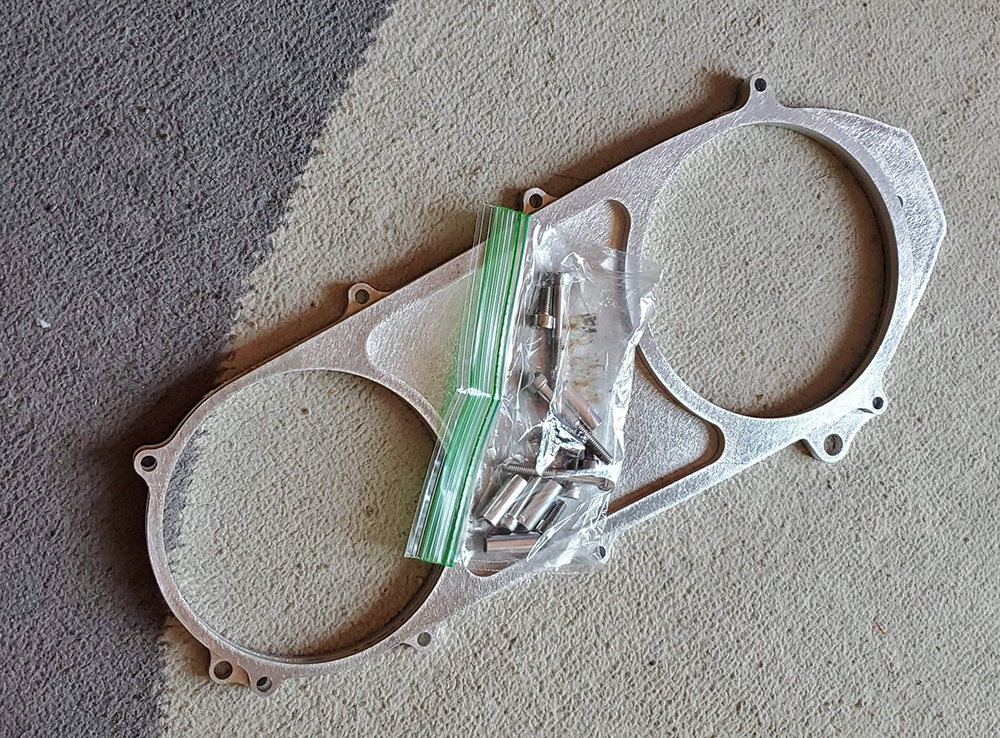

So I have always been a fan of Custom CVT covers and/or Ankle Biters. I think it gives Scooters such a custom frankenstein look to them. Even uncovered CVT's look crazy and rugged. So I found a guy Harvey that has been cutting and selling PCX Ankle Biters and instantly bought it. It came rough from the raw Aluminum so I wanted to do some step sanding and polish it.

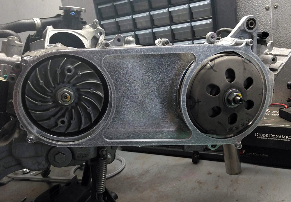

Took about 8 hours of step sanding and hand polishing but It was well worth it. Painted the Bell to give a nice contrast. Enjoy.
So this is how the cover comes. Raw Material + Hardware.

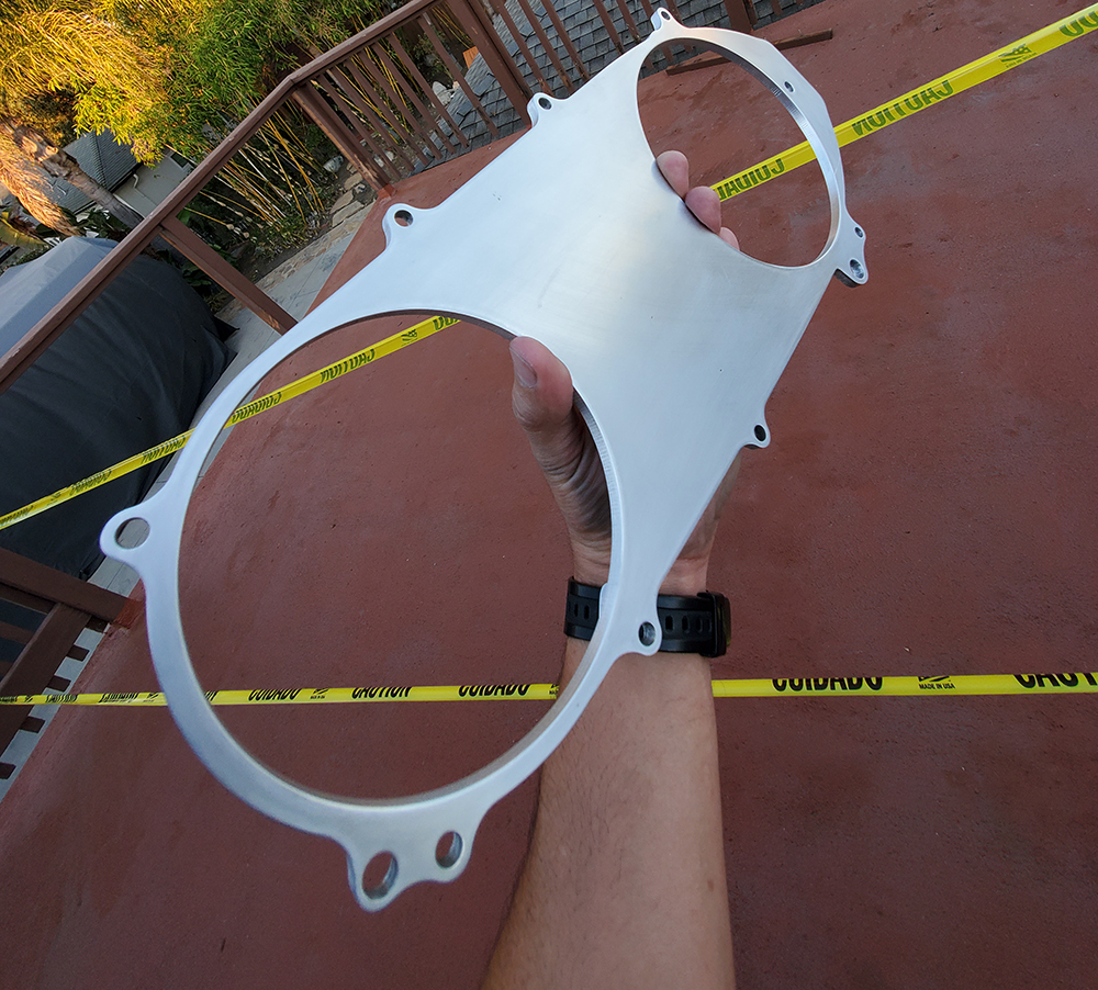

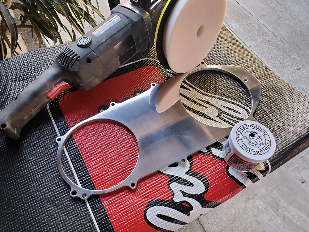

This is after 350/400/600/1000 wet sanding then first pass with Mothers.
Tried a buffing pad but due to it being so thin, I just ended up finishing it by hand.

So your'e gonna run the scoot with that part right there open?

Personally, I'd be concerned about running the clutch assy without the left hand end of the shaft being supported (The original CVT cover has a bearing that the shaft is supported by).
Re: Ankle Biter
Coasting wrote:Personally, I'd be concerned about running the clutch assy without the left hand end of the shaft being supported (The original CVT cover has a bearing that the shaft is supported by).
+1
Yep, bearing is out there for a reason.

o_O I just don't understand how people can come up with such [stupid] idea's, the complete CVT is covered for a reason by the manufacturer.
Sure it looks nice but spend a little more money and buy / make a transparent cover to protect the CVT and yourself if you want to show the CVT assembly ;)

ha ha ha ha. I love the hatred for anything Original in this group. Im a form over function kinda guy (with a very well tuned bike). :D
I'm not one bit worried about anything going into the CVT or clutch, nor worried about any extra bearing wear due to removing the clutch shaft bearing. Ive run with no CVT or open cover on multiple bikes with no issues. Its not a GY6 so Im not worried about Swingarm cracking plus this bracket is just as sturdy as stock.
This is not my primary transport so if something fails, I'm not walking. The sound and look of this thing is well worth the risk (which is very minimal).

I like it. I understand why you did it, and obviously you’ve got some acumen about this because you own Flex Rotary… Don’t know too many people that have that. I do worry a bit about the rear bearing not being supported, but only if I was going to keep something for tens of thousands of miles, and ride it into the ground. I don’t keep my bikes more than three years, I like new stuff. So it wouldn’t bother me. I actually may do this modification.
Ps With that rotary you could probably get it to be a mirror finish using a true polish set, like Meguires 105 and then 205.

Jge64 wrote:I like it. I understand why you did it, and obviously you’ve got some acumen about this because you own Flex Rotary… Don’t know too many people that have that. I do worry a bit about the rear bearing not being supported, but only if I was going to keep something for tens of thousands of miles, and ride it into the ground. I don’t keep my bikes more than three years, I like new stuff. So it wouldn’t bother me. I actually may do this modification.

I didnt use the hand buffer/Flex Rotary too much. It was a little too hard to hold the part and polish it at the same time. It was mostly done by hand so not the best finish. Im hoping next time it needs a good polishing I can get my hands on one of these. Then for sure it would be a mirror finish. ha ha ha ha

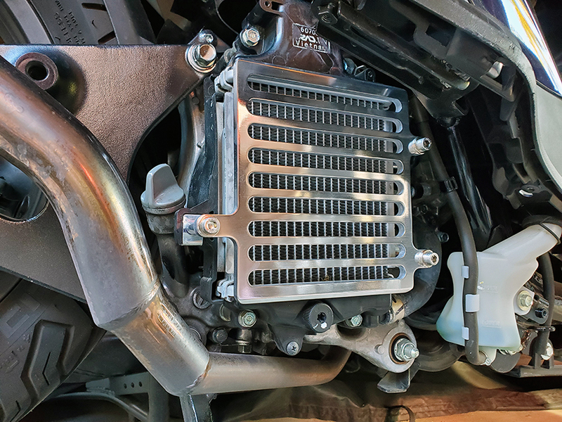

Finally finished my radiator cover. Didn't polish it like I did the Ankle biter but I'm happy with it. If and when i stretch it, should look real nice.

Re: Ankle Biter
Looks great.
What is the weight compared to the parts removed?

you you wrote:Looks great.
The CVT cover for sure weighs less. lol The Rad Cover probably weighs more. ha ha ha
