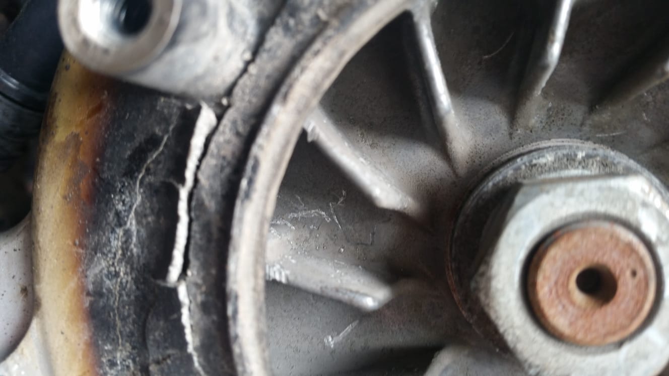

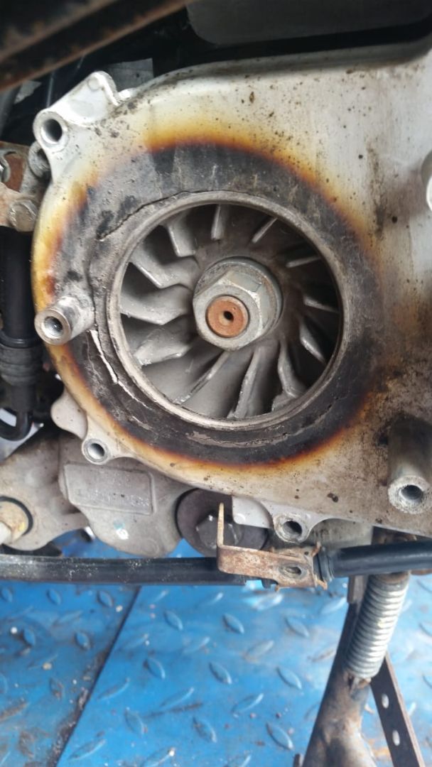

Hi guys,
Any idea what could have caused a disaster like this??? o_O
I'm waiting the new carter to arrive (11341-KWN-780 for PCX 125 2015) to open transmission and check CVT Variator and Clutch inside... let's hope for the best! :roll:

What's the backstory on it. Did it happen after a CVT service or did it just happen out of the blue. What noises did you notice before and during the occurrence. From the picture, it looks to me like the crank moved out a bit.

from the scorch / burn marks it looks like the cvt belt is rubbing on the onside of the casting
Re: CVT Carter destroyed
Looks to me like incorrect parts have been used causing the fan blades to be in contact with the casing.

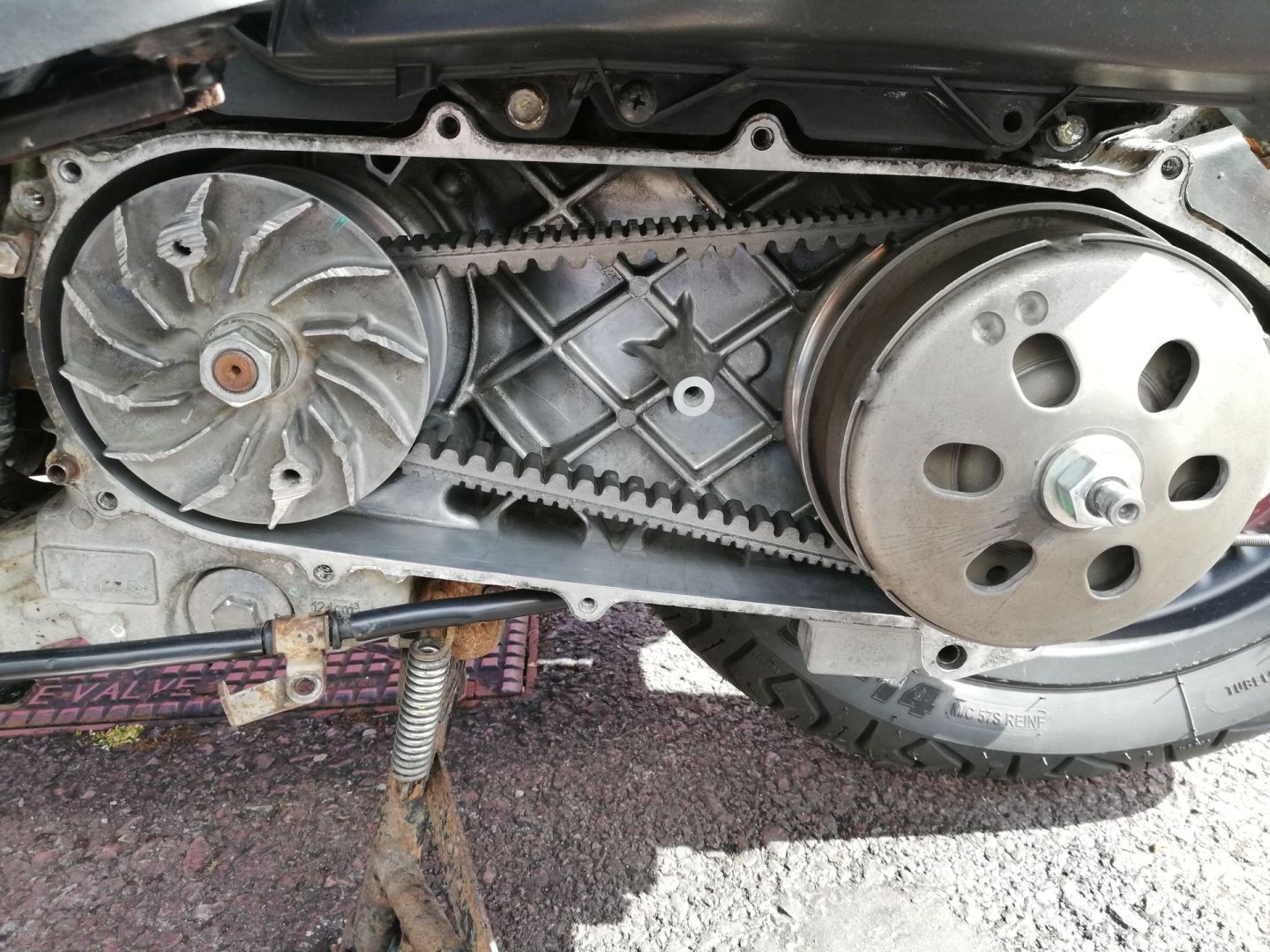

on your first image it looks like the fan blades have been catching against the casing ....Has the bearing failed? Can you hold the big nut and move the fan and shaft sideways ? does it wobble about ?
TheDoors
Posts: 43
Joined: Tue Jan 28, 2020 6:11 pm
Location: Ireland
Post by TheDoors »
Yorkie150 wrote:on your first image it looks like the fan blades have been catching against the casing ....Has the bearing failed? Can you hold the big nut and move the fan and shaft sideways ? does it wobble about ?
Yep, I've noticed the same detail, so or the central nut has not been properly screwed or they used wrong parts as Gn2 advise, but for the burn signs it seems to make really a lot of friction like metal with metal... I will let you know soon guys, thanks for your help :)

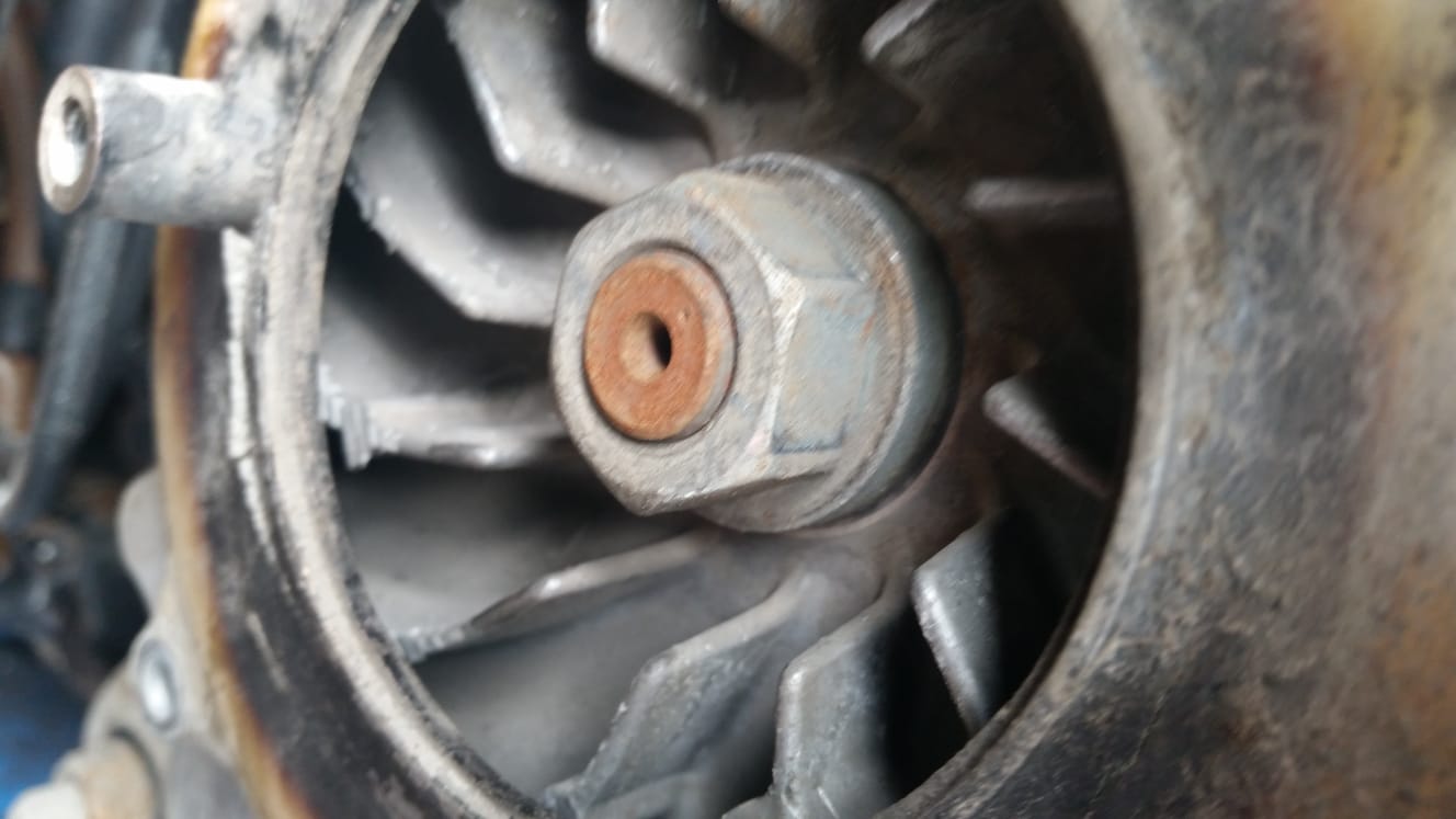

Central nut, washer, or when the variator was re-fitted, they did not have enough flex in the belt so the variator does not sit far enough in when tightend - it's a real pain to do this sometimes and to do it properly, the clutch needs compressing and held when the belt it re-fitted, then tywrapped to allow the clutch to not expand and the belt to ride to the outer edge, which then means there is not enough slack to get the variator sat properly.
Not the best description, but anyone having removed the variato/clutch knows what I am talking about :)
With less than £100 of new parts, assuming no internal engine damage, that can easily be resolved.

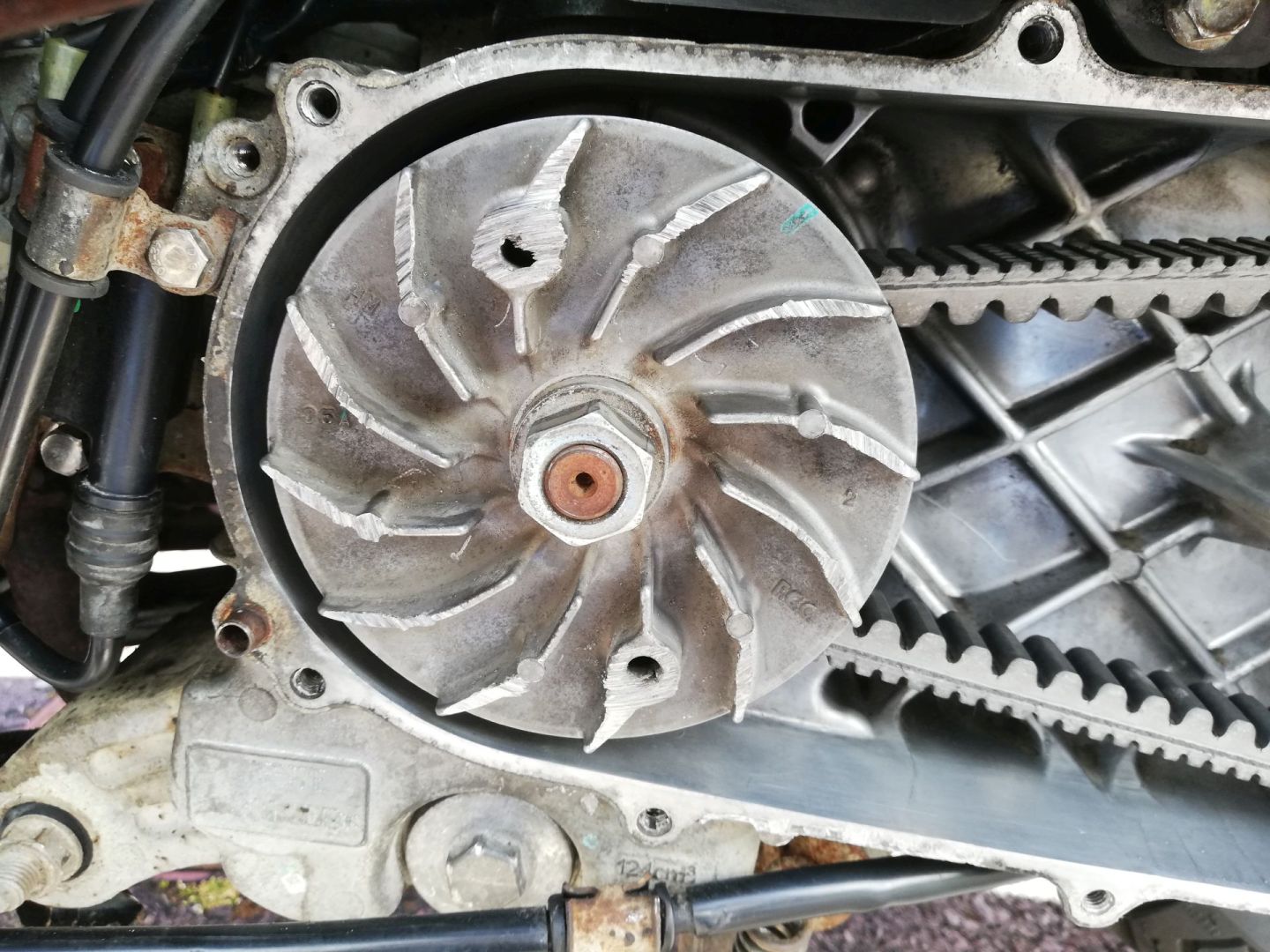

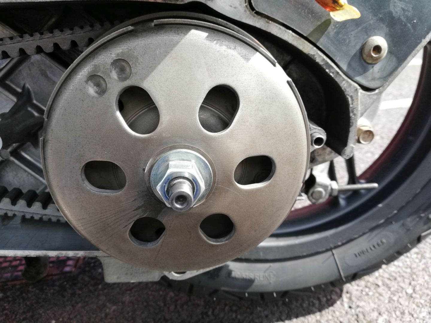

As advised cover removal has been tricky but at least I've been able to open, inspect and clean what it was possible without a CVT holder tool to remove Clutch and CVT. I used Break/Cluth cleaner and a microfiber cloth.
The picture is the final result of the cleaning process, and it was extremely dirt and neglected.
As you can see the half pulley has been touching the cover for looong time, so should be imediately changed, but I will need to figure out if the wrong pulley has been used or any other issue could be present. On the other hand the rotation of the cluth is quite noisy, probably shuld be changed the wieghts if not the bell too.

When I changed out my weights I failed to use a torque wrench. After a mile of riding that nut unscrewed itself and the variator ground itself through the casing like you have pictured.
outlander wrote:When I changed out my weights I failed to use a torque wrench. After a mile of riding that nut unscrewed itself and the variator ground itself through the casing like you have pictured.
That was my thought as well. From memory it looks like the crank nut is backed out too. Not enough thread showing on the crank?
