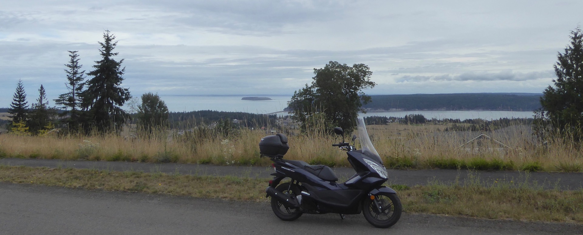

Thanks again for the top box/bracket tips!
I got to tool around on this full moon Friday the 13th...
Loving the new (to me) bike, larger windscreen, and top box!
peace

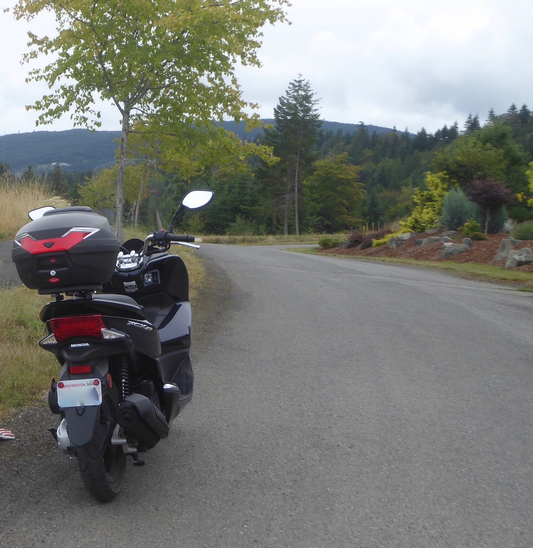

Re: Help: Top Box hardware
Post by ChuckD »
The view from the rear...
