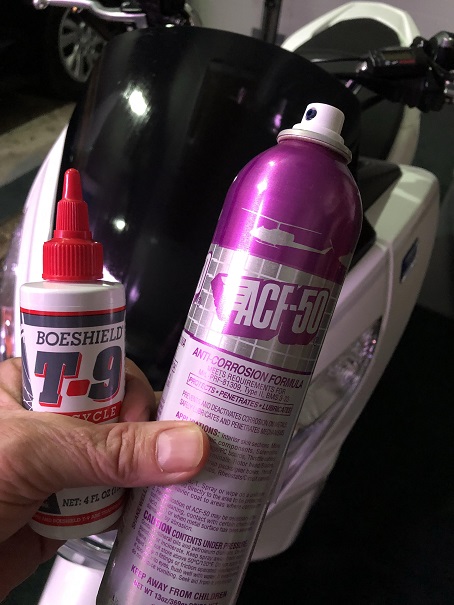

Boeshield T-9 is much easier to work with after application. Polishes very quickly to a glossy finish suitable for head and tail light len's, painted finishes, chrome, aluminum, glass etc. All hardware and electronics can be sprayed or wiped down as well clearly making it the superior choice of anti-corrosion products. Boeing wins this one... made in the USA! 8)
ACF-50 remains greasy until rinse and wipe down never reaching a polished result on your finer finishes to my standards. It will attract road grit until after the first good wash and wax so too much work for the meticulous motorbike enthusiast who likes pretty as much as performance. If it's all you've got please use ACF-50. It's still far better than nothing for the all weather rider.

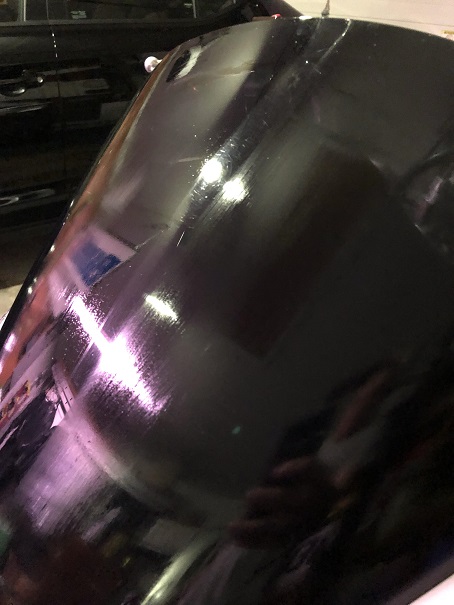

Boeshield T-9 is the ticket boys and girls if you can find it in decent quantity. Windscreen test did it for me hands down Boeshield T-9 is the easier anti- corrosion product with polishing properties as the deal breaker. Now to get a tub of it cheap as possible and find the proper application sprayer.
Product description;
Unique solvent and paraffin wax formula penetrates, cleans and displaces moisture. Dries to a thin film that lubricates and protects for hundreds of miles. Will not wash off or pick up dirt.
Application;
Apply and allow to penetrate and dry for 2 hours or more, wipe off excess.
anti corrosive.jpg (90.31 KiB) Viewed 4688 times

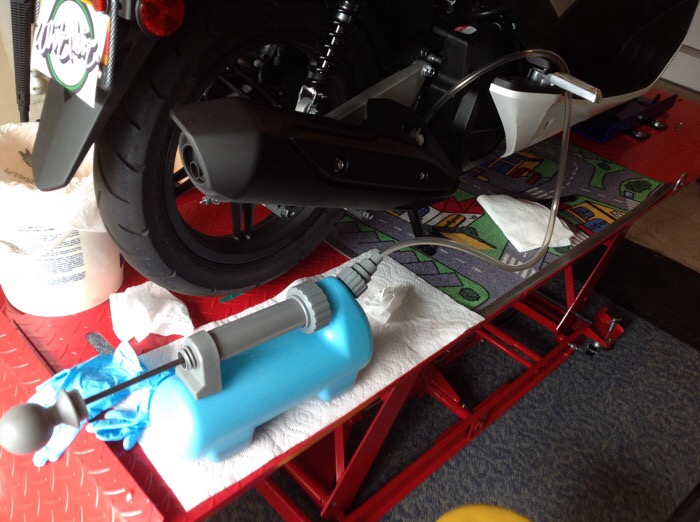

Yeppie! Ya know me! In small, medium and large varieties :lol:
Fact is the (dip stick) oil portal is so small/narrow for the extractor's fat hose. I have to adapt a smaller hose to each extractor's hose in order to get it inside to draw at least 95%.
Truth? I could use a syringe and just take my time. Sitting on my roll-away shop stool of course, beer in other hand. Not so Chintzy :lol:
What is it about the drip method that keeps me going back? Old and old fashioned, I guess.
No worries 2yous, I will hook up with one of the 3 in a few weeks, before tucking WN in ;)
This might be the mothership extractor (I posted several years back) that you might remember...in size large

I should have known :roll: :lol:

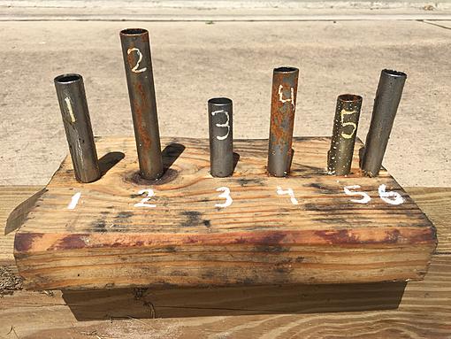

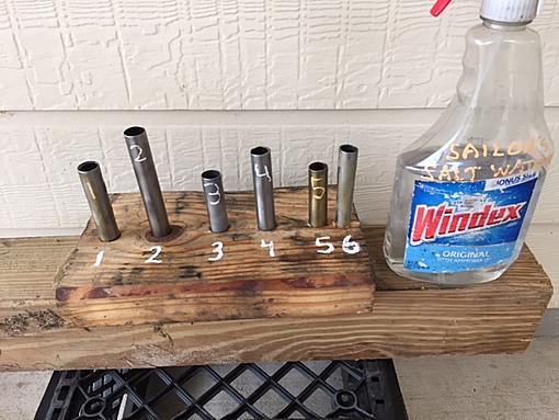

I've stumbled across many interesting tests of protection products for bicylcles, motorbikes and tools, and this set of tests is quite an eye opener for epic failures, although each product may fair better for different uses (no ACF-50 in this test!)
http://forums.mtbr.com/fat-bikes/anti-c ... 73581.html
T9 seems to get a mixed bag of good and bad reviews for rust protection from actual users.

iceman's find is excellent! http://forums.mtbr.com/fat-bikes/anti-c ... 73581.html
I've never heard of Fluid Film but WD-40 is certainly impressive and readily available & affordable. Really appreciate the clarity on this. youyou was on the right track all along with WD-40 products.
Winners are for salt water protection;
Fluid Film
WD-40 long term corrosion inhibitor
Who knew? Probably still attract dust and road grit but why pay more for less protection. https://www.amazon.com/WD-40-300038-Spe ... 14QHTJV6JX
