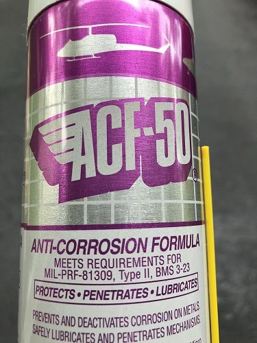

I wanted to give my opinion on this product. First it's marketed to protect against corrosion both preventive and existing. Safe to use on all metals, plastic, electronics, switches, whatever you need. Rain, salt spray or damp humid conditions the naturally corrosive elements of time will be stayed off. If you have the need ACF-50 will do this for you no doubt, but there's things to consider.
This is seriously going to help our friends overseas who ride all weather conditions and want a bike that looks like mine. However ACF-50 is overkill for fair weather riders like me who sponge bath and spritz a good quality liquid wax several times a year on their scooters.
Be ready for the effort ACF-50 takes to process a motorbike, it's monumental to do it right. ACF-50 would be well worth it needing only apply once or twice a year for the all weather riders.
ACF-50 is made for Aircraft and water sport vehicles. Says nothing about motorbikes that need to balance on two wheels with disc brakes so take caution. It's going to be scary slathering ACF-50 on a motorcycle. I found it impossible to keep it off places I didn't want and now I have a nicely sealed asphalt driveway that doubles as a slip and slide after using ACF-50 :roll:
Trying to state the pro's 8) One 13 ounce spray can is more than enough for any motorbike. It fans on thick like spraying motor oil. It wicks into every possible crevasse and sets up excellent to bead water and seal off moisture. Perfect for your black plastics and conditions them nicely but excess has to come off as well as be removed from glossy plastics... it's not a wax and won't behave like one.
There's no way to avoid getting ACF-50 all over everything even if you're a monk like me. You'll need to remove the excess after a few minutes of saturation. You can't go riding off all greased up in this molasses or you'll surely crash. So yes, you must rinse after some time and try to remove it from polished surfaces, brakes, tires and... the floor o_O
Here's what to expect... you'll clean your bike before you apply ACF-50, you'll clean after you apply ACF-50 and then after a hair raising ride you'll find road dirt sticking to your bike and you'll clean AGAIN o_O WHY? because its NOT an airplane OR a boat :roll:
As a fair weather rider I get on fine with liquid waxes verse the difficulty and hours of labor using ACF-50 will put me thru for the protections but I certainly wouldn't rule it out for the guy who rides all weather if he wants a pristine motorbike after every wash year after year. I believe ACF-50 would preserve a piece of baloney for a year on the beach :lol:
In conclusion my street fighter looks GREAT now but it took a lot of work and all day to process ACF-50. I won't be applying ACF-50 to my scooter unless all the skins came off. You can't get to the electrical and frame with scooter cowlings and panels so maybe wait until your valve clearance check using caution and patients applying ACF-50 to your precious.
Just my opinion, what's yours?

This guy did a much better job of managing the overspray than me.
Re: ACF-50 review
Put lots of paper under the scooter/motorcycle.
I used rags, 1" & 4" paint brushes, bowl and the spray wand to apply, spread and reach every bit of metal I could get at, including under the seat pan. No issues getting it on electrical parts.
Stay away from tires, brake pads and discs, obviously. Did not apply it to chains , but wiped it on sprockets.
Smells, but cooks on hot parts and exhaust parts after a couple of rides.
I wipe off clinging road crud on places visible to me for cosmetic reasons only - aftet this first wipe down no more issues with road grime than I'd normally see. (Its now dry, and protecting)
Once a year on exhaust, side and center stands, CVT covers, engine bottoms, shocks, etc. Places exposed, vs places within and protected by scoot's bodywork.
Get it on while scoot is new ....but also does its work on older parts, too
I like it...and promote it to others.
It's your ride and your $.

No, I didn't tear down the Buell so there are many places that did not get treated. I agree with Fish about doing this when a motorbike is new and then once a year or so depending on exposure if you want excellence. Ideally I should have done this as I restored the Buell.
For the PCX the valve clearance check would have given access to most the scooters underpinnings with exception to the fairing area. I would not want to get ACF-50 too close to the dash display, headlamp, turn signals or tail light assemblies not because it would hurt anything but that it might leave residue visible inside lenses and displays you couldn't reach to wipe off. Emblems, decals, badges, pinstripes might also be of concern because this might weaken adhesive products. I could lose the wheel stripe on the Honda if it does, whats your thoughts on that people?
I will say from now on for me through the course of ownership on a new or used motorbike I will keep a can of this handy using as I access or teardown for aftermarket equipment installation or replacement parts as needed. I don't see me tearing down completely a new bike to treat as a whole... maybe, depends on the bike I guess. But ACF-50 is certainly tempting and desirable to use. Just enormous work do so. As for anything with a motor under a hood... car, truck, airplane, helicopter, jet ski, engine rooms on boats etc. I would blow down and let drip dry and forget about it. It's just a little tedious for a motorbike because we tend to fall off and need to brake... but I'm a fan now 8)

You cant just spray the stuff from the can. It just doesn't apply well like that. Best to get a bottle and thin. Then spay if you must but brushing a thin film or a dipped rag is best.

When I've applied it I've sprayed it into the cans cap then used a paintbrush to apply, saves it going to places I don't want it to.

homie, any idea how this product compares to Boeshield T-9? I've used T-9 for more than a decade on my bicycles, for everything from internal frame corrosion protection to chain lubrication.
Re: ACF-50 review
Eiron wrote:homie, any idea how this product compares to Boeshield T-9? I've used T-9 for more than a decade on my bicycles, for everything from internal frame corrosion protection to chain lubrication.
I ordered this right away because of the product claims that seem to understand my slightly negative experience with ACF-50. After reading dozens of comments from Amazon customers on Boeing's aircraft anti-corrosion product 'boeshield-T9' the complaints are all to do with the aerosol spray cans. Multiple customers complain the aerosol can fails leaving them with worthless product. Some claim there isn't the stated ouches in the can but probably were experiencing the same issue with clogging.
Naturally I wanted the pump after reading that. Or just give me the liquid but it isn't sold in practical quantity. Either you buy 4oz pump bottles for 14usd or 1 gallon jug for 150usd. Still there is excellent review that Boeshield DOES NOT leave a sticky film to attract road grit and lasts longer (wash after wash) than all similar products. I'll know if some of these claims are true soon enough.
If Boeshield does dry completely with no sticky residue for the same protection as ACF-50 then yes it would be the superior chemical mixture in comparison to ACF-50 for the simple reasoning you wouldn't have to double handle the finishes after application other than to buff the dried waxy residue to a polished shine on glossy finishes and chrome. Keeping fingers crossed and thanks for the interesting product suggestion.
Note they still shy away from using on motorbikes... obvious liability reasons :lol: keep these products off your tires and brakes

Be careful with tyres, yes, but there's no need to worry about a little over spray in the brake discs. It burns off in no time if you apply the brakes a few times on your first ride off. It won't contaminate the pads unless you get a lot of the stuff on them.

Boeshield is great stuff, however you want to use it for things you're not gonna have to take apart too often or even at all. Because it sets up a very waxy surface that rises to the top after you spray it. It was invented by Boeing to protect their aircraft that they used to put in storage. But you don't want to try to take apart something like a terminal block sprayed with the stuff, it's messy… And waxy…
