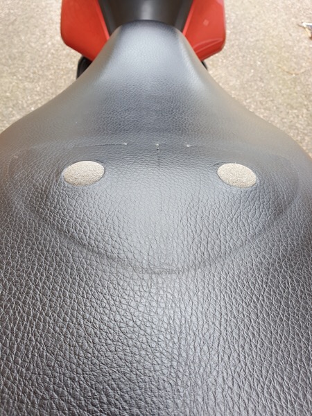

I decided to have a go at a very minimalist approach to 2010-2013 PCX de-humping.
All it needs is pieces of cloth, foam, whatever small scraps you have to hand. These bits are fed through the two holes in the seat cover to pack the space around the two humps.

First, fill the ‘valley’ between the plastic humps (shown from underneath) with pieces of fabric and pack down firmly.
Then fill the spaces as evenly as possible between, behind, in front of, and at the sides of the two humps.
Finish with pieces of cut foam.
That’s it...
A very positive and comfortable first test run. I’ll see how things are from here. But at least it cost nothing other than some time.

That works too. What’s your plan for the two holes?

jburner wrote:That works too. What’s your plan for the two holes?
For the time being I’m going to leave the two holes as they are, so that I can adjust the padding if I need to. Once/if I’m happy with the result I’ll stick a couple of patches over them.
