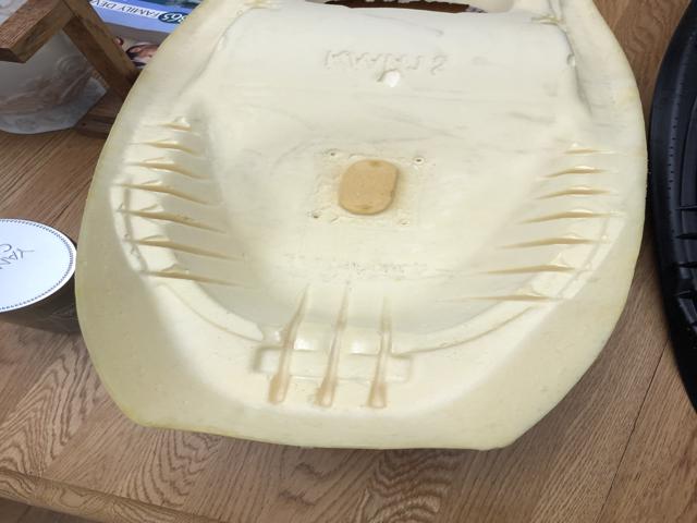

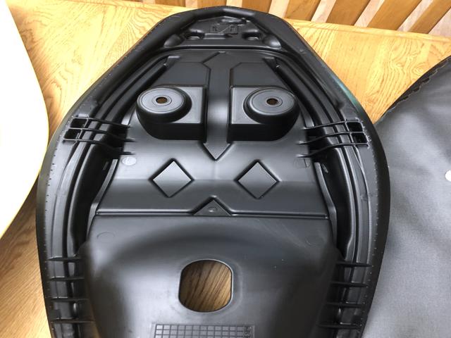

Disassembly of seat, pad, and plastic "pan"
Stuffed the tapered hole with furniture padding left the small indentation for the hump as somewhat of a seat form. I think it looks ok that way after I covered it.
Melted cut out the rounded portion and cut slits in the sides in order to bend the plastic down. My piece of wood left indentations on the plastic, but it's quite solid now. Not the prettiest though...

Very interesting seeing the seat once the cover is removed, especially the foam padding. So from what I can see, there is a circular recess in the foam padding around the area the hump was?
Correct. On the back side its is tapered to match the plastic blow mold. See pic #2-3
Did you try just filling this space with foam or padding first, before cutting into the plastic cones to make the tabs?

I filled the space with foam knowing that I was going to flatten the plastic. It was all or nothing kind of thing. I was going to try to soften and push them down without doing any cutting and realized that the plastic would have bunched up too much to be a flat structure for the foam to sit on.
