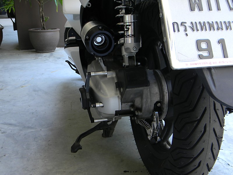

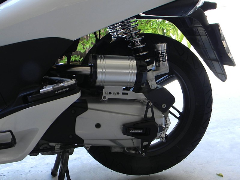

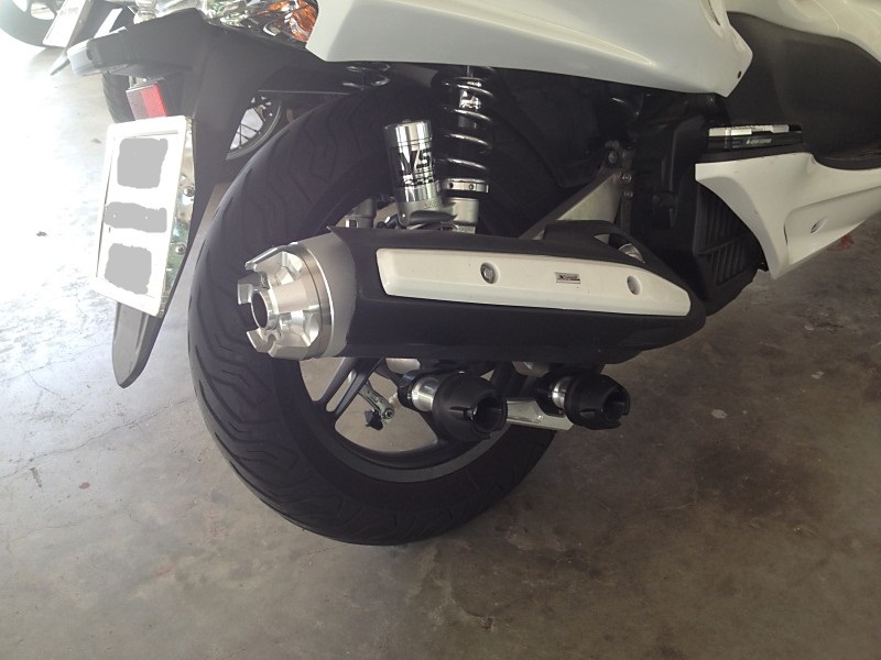

Re: [PCX 150]: Engine guard?
I have the exact same CVT cover guard/protector and one on the other side to protect the muffler (see pics below).
I laid my PCX down on the CVT side at slow speed on very smooth and slippery concrete. My foot got caught between the ground and the seat. The was no damage to the CVT cover or the guard/protector. The bolts did not bend.
As far as the expense of the guards, because I am in Thailand they are very inexpensive. I can't recall exactly how much they cost, but I am positive they were less than $30 each, and likely closer to the $15-$20 range.
I put them on for two reason. 1) I like how they look, and 2) To help protect against curb scrapes which are not uncommon when riding between the curb and cars waiting for lights to change, which a common practice in Bangkok.

kramnala58 wrote: I laid my PCX down on the CVT side at slow speed on very smooth and slippery concrete. My foot got caught between the ground and the seat. The was no damage to the CVT cover or the guard/protector. The bolts did not bend.
That is because it didn't make contact since the centre stand sticks out further when retracted.
If your stand was pushed down by a slide/spin you would find it to be a very different story.
