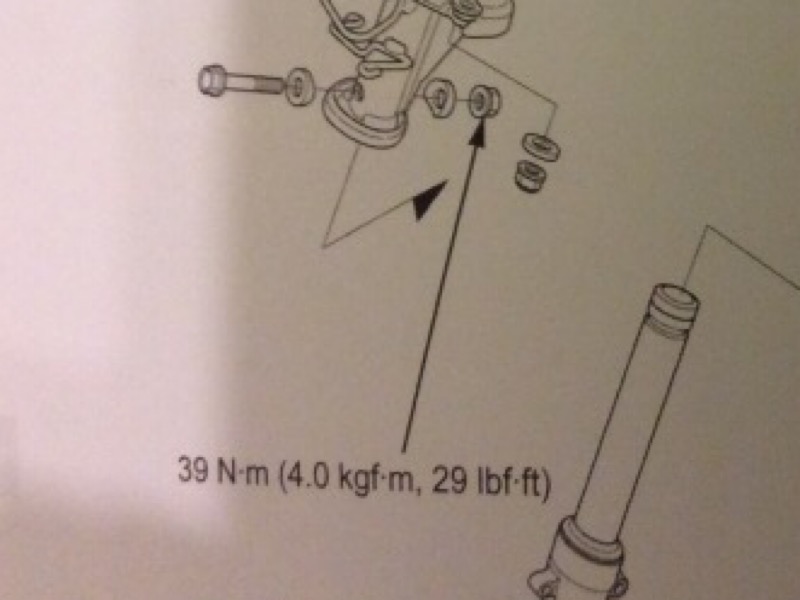

If one looks immediately to the right of the "44N-m(4.5kgf-m, 33lb-ft)" one will see what looks sort of like a Y shaped doohickey, into which the bolts on the curved thingamajigs run through where those little cap-cover gimcracks (the ones I was supposed to remove with duct tape or have fly all across the garage) cover.
I don't really see that there's any kind of nut there, and it almost seems to suggest to me that the inside of the doohickey is threaded to receive the bolt from above.
The nuts to which you refer, Paul, appear to be holding those doohickeys to some other whatchamacallit, where the bolts on the Y shaped doohickey go through and are held on by nuts from below. These weren't the ones to which I originally referred.
My head hurts now.
My head hurts now.

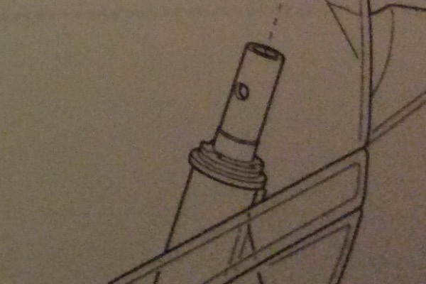

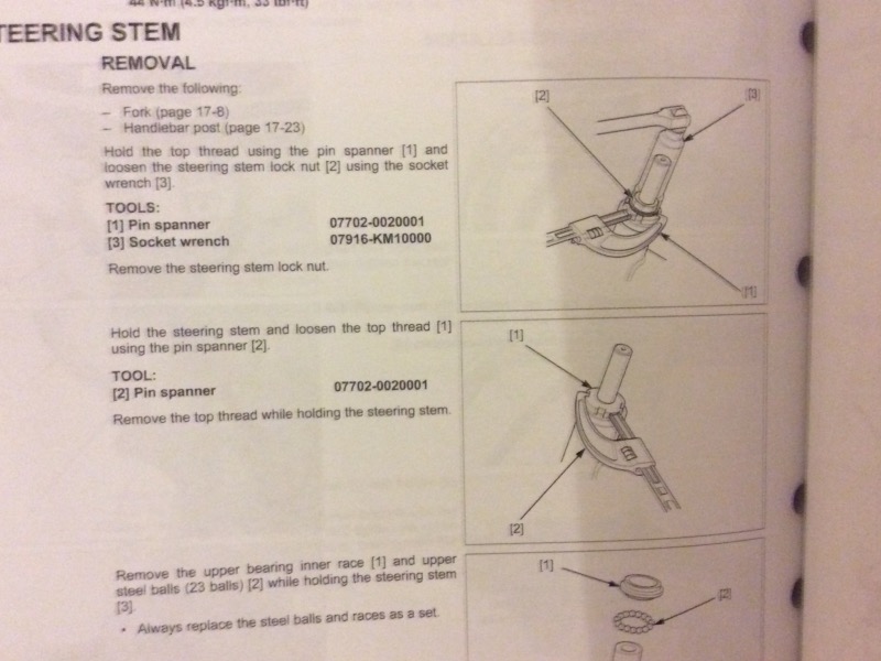

Wrong nut. But neither of those are the steering head/stem nut. That's in the picture but not labeled. The nut I was mistakenly referring to holds the handlebar assembly to the steering stem.
The first pic shows the locknut on the steering stem. It's badly drawn, but the other post I made about it shows how the spanner fits on it.
My favorite far side is attached as well.

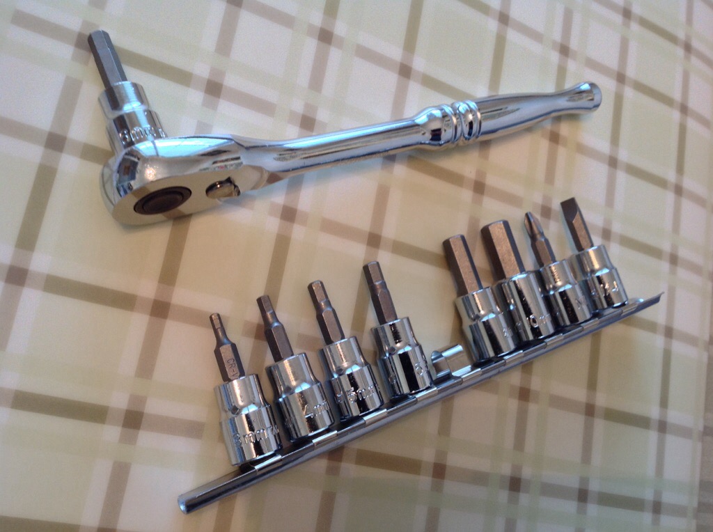

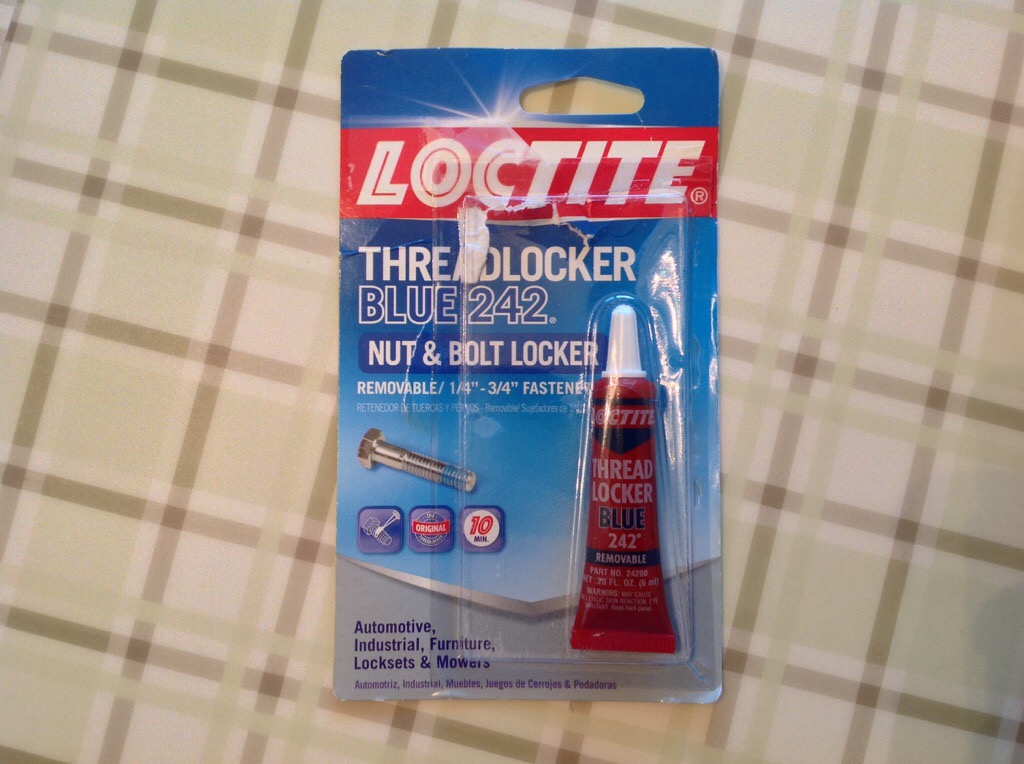

Ish, you've been confusing me as well. Let's stay on topic, or at least one at a time. Agreed? Cool.Ishkabibble wrote:The question I still have, is about those four bolts (the ones with the heads under those cap thingies). Do they, or do they not have any nuts under the bottom, or is my viewing of the service manual correct in that the thing they fit into is threaded?
Most importantly of all, what is the exact tool used to loosen those bolts, so that I can rotate the handlebars back a little?
Alright then, below are the tools I found easiest to use. A ratchet and 6mm hex head drive.
Note: be aware of torque power. Do Not over tighten those 4 bolts when you turn them back in.
And answer to your question: No nuts are "under the bottom" of those four bolts. Receiving end is threaded only.
*When you're finally comfortable with your bars position, take those 4 bolts back out and dribble some Loctite Threadlocker "Blue 242" on the threads and put them back in.
