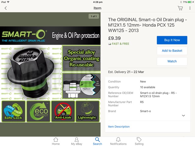

What is the correct thread size for 125 pcx for a stahlbus?
20x1,5 ?
20x1,5 ?

Anyone knows please?tomtomclub2005 wrote:What is the correct thread size for 125 pcx for a stahlbus?
20x1,5 ?
- Alibally
- Posts: 1761
- Year: 2019
Re: Anyone using a Fumoto oil drain valve on 2013 PCX150?
Thread size.
- ImageUploadedByTapatalkHD1489940904.821950.jpg (72.69 KiB) Viewed 3934 times
Thanks Alibally!
