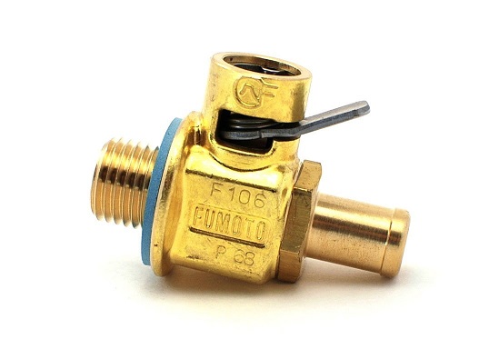

On my next oil change I'm considering installing one. I didn't find much on a search here, so I'm asking if anyone is currently using one on a '13 PCX150, which model#, and does it hang lower than the exhaust pipe?

Will try to mount the fumoto 107s I have this aft...?Not sure this will be the final adapter , but stay tuned may mount stahlbus later....

The idea is to replace the oil drain plug with a ball-valve. The important thing is whether it hangs too low (below the exhaust pipe). I've ben discussing it with Glen who has two types to try. One is the Fumoto and the other comes from Stahlbus. He's going to try them out and let us know which is his choice. I'm not too hot n the Stahlbus as it requires me to keep track of an extra part (the male quick-connect fitting). The Fumoto is a simple ball valve with either a short or long exit nipple. Thank you, Glen, staying tuned!

http://www.amazon.com/Fumoto-F-106N-Eng ... B003T7XUE4
- drain.jpg (40.89 KiB) Viewed 6270 times

Of course that's not the one to use.....and yes, it can't stick down more than other components. I know where and how I drive so not worried about rouge undulations that would tear up the crankcase. If I hit something hard enuf to tweak this valve, I've got bigger problems that the valve.

On the PCX it'll stick down about a cm more than the current bolt, but not sure if that will cause problems with speed humps and such (probably not with all the other gubbins down there). What size is the PCX drain hole - 12mm? (is it the same as the bolt 'cap' size itself?)

drain plug is M12 x 1.5iceman wrote:On the PCX it'll stick down about a cm more than the current bolt, but not sure if that will cause problems with speed humps and such (probably not with all the other gubbins down there). What size is the PCX drain hole - 12mm? (is it the same as the bolt 'cap' size itself?)

the 12 x 1.5 F109s is the one that fits, but I don't like the result. There is a casting ridge in front of the oil drain bolt that would require a longer neck on the valve to get it snug, or an extender which would make it hang down too much..... have a call into Fumoto tech Support to discuss....looking more and more like the Stahlbus will work better....

Jge64 wrote:the 12 x 1.5 F109s is the one that fits, but I don't like the result. There is a casting ridge in front of the oil drain bolt that would require a longer neck on the valve to get it snug, or an extender which would make it hang down too much..... have a call into Fumoto tech Support to discuss....looking more and more like the Stahlbus will work better....
I use these occasionally. But there not for a PCX really. First speedbump....
