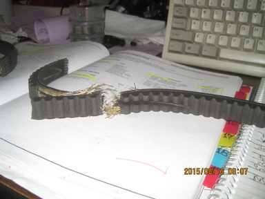

[quote="waspmike"]: ? I can still see a crack in the belt.[/quote] o_O
I am ready to express my final opinion on this very interesting debacle.
Unless something else comes to light.
The belt broke first and caused this.
01 torn-busted belt 1 324k.jpg (100.92 KiB) Viewed 4972 times
01 torn-busted belt 2 324k .jpg (132.54 KiB) Viewed 4972 times

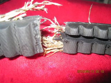

If we examine these two photos we can clearly see the grove in the right hand section of belt where the movable pulley got a hold of it.
On the left hand section of belt, there is no mark at all matching the pulley.
Also, we have the visual crack one cog over from the split.
So, I would go with the following.
Zipping along at fifty to fifty five mph, the belt broke.
Normally the belt would just let go and we would have a running engine with no output to the rear wheel.
In this case, no such luck - and hence the confusion over possible causes.
Belt broke and due to timing - a split second sooner or later would probably change the outcome.
Forward section of belt to your left broke loose and simply flipped around pulley and fell to bottom of CVT case.
This of course unloaded the torque driver pulley allowing the clutch to drop out.
This all probably happen in a milly second or so. This is likely why I felt no shudder or hiccup from back wheel.
The section with the grove in it - when the belt snapped, it happened in such a way as that section of belt moved to its right.
The variator movable plate was able to grab it due to speed and location and drag it up against the top of case.
This of course jammed the pulley and stopped the motor.
Maddie asked if there were any rub or wear marks on variator case - there were not.
No marks would indicate that this was a sudden failure and not something that built over a period of time.
