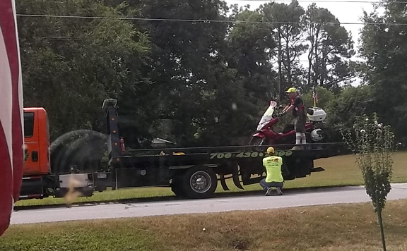

PCX zipping along – engine died – turned over but no start.
Wednesday I left home – stopped and topped up gas – rode up to clinic about 40 miles.
Scooter ran great.
Came out of clinic – started right up.
Scoot was running very nicely on trip home with no problems
when at about 30+ miles it cut off at about 55 mph or so.
I coasted along till I found a safe spot to pull off the road.
Tried for restart.
Maybe twice engine sputtered for a moment – then died.
Tried again but battery now too weak.
This was about noon and temp was in upper 90s with heat index of maybe 105.
No shade tree handy so –
[/size]
PCX on TowTruck Sad day 1st crop 600k.jpg (186.31 KiB) Viewed 9882 times

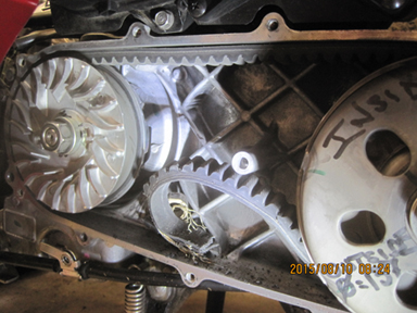

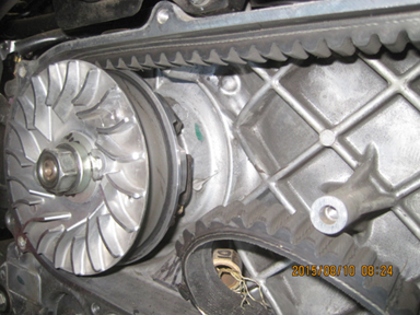

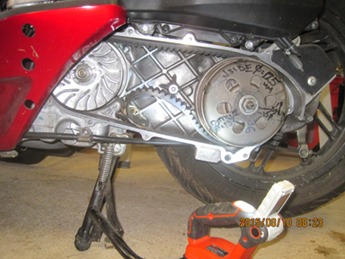

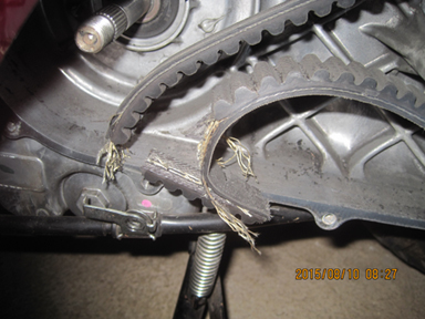

Hay Inoplanetyanin
Some good thoughts - and one sentence made me think that I had overlooked a simple check.
You said.
If still nothing, turn the crank manually (will have to take off the cvt cover for that) and see if the engine has unusual resistance in it.
I thought - self - why have you not cranked over the engine manually??

I pull cover and what do I see ???
PCX CVT 1 cover pulled 324k.jpg (134.97 KiB) Viewed 9728 times
Well there’s your problem! :o
PCX CVT 2 belt broken 324k .jpg (123.43 KiB) Viewed 9728 times
The belt is broken, jammed and some of the sliders came out of variator.
PCX CVT 3 belt broken jambed veriator 324k.jpg (124.74 KiB) Viewed 9728 times
Not sure how well you can see it but if you look at upper left of this photo
you can see that belt is slightly twisted and wedged between veriator and cvt case.
NO WONDER MOTOR WOULD NOT TURN.

and finally the belt itself.
PCX CVT 4 belt broken 324k.jpg (114.17 KiB) Viewed 9728 times
So – now we know why motor would not turn over.
BUT - we don’t know why everything fell apart. :?
It’s the old who came first question – the chicken or the egg ?????
Veriator nut still in place and properly tight and no damage to any components.
After I get all the tupperwear back on and have a chance, I will play around with the variator and see if I can duplicate the sliders coming out.
Some time in the next week or so I will start a new thread to talk about my CVT set up and thoughts on this incident with sliders coming out.
For this post I am happy to say as soon as I cleared the jamb the engine started right up. :D
