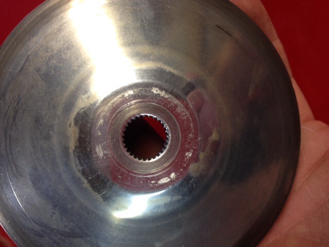

Here are the pictures of my yuminashi variator with the finish popping off after 2000 miles. I enjoyed it but I enjoy my daytona with sliders far more.

This happened after two belts came apart because of a bent drive gasket. I replaced the gasket and locator pins and no more issues thought I get the same top end out of a Daytona variator.
