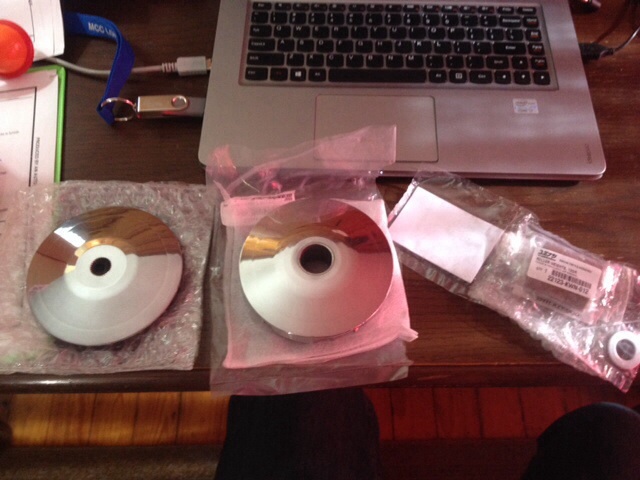

Here it is. I'm going to email yuminashi to find out if there are supposed to be lines on the pulley halves. Also the ramps are rough. It's different so I'm going to address it. Excited nevertheless.

Mgalutia88 wrote:Here it is. I'm going to email yuminashi to find out if there are supposed to be lines on the pulley halves. Also the ramps are rough. It's different so I'm going to address it. Excited nevertheless.
Not sure Id be happy about that. Can you feel the ridge with your nail?

You can feel the ridge however it's a very smooth rounded ridge.

After the ridge is the vario face diff angle? Like a two stage face gearing...that would explain its ability to get such a high top end.Mgalutia88 wrote:You can feel the ridge however it's a very smooth rounded ridge.
Can we get more photos of the other side and also is outer diameter measurement?

The seam looks to be a casting seam of sorts. It's been polished over. I'm actually wondering if there are multiple profiles on the pulley halves. I'll know when Masato emails me back tonight. I usually get replies from him between 2-5am our time. I'm central standard time zone.

I'll measure it tomorrow Vlad, that's my theory as I asked Masato about it. The drive face has the exact same seam in the corresponding spot. Btw do you know where Yuminashi is based out of?

Here is part of the reply I received from Yuminashi,
"You are correct about the visible line on both the pulley halves, the pulley ramp has multiple angles on both the faces which we have made based on the RPM's/speed your engine is making.
You could compare it with normal gears from a car or motorcycle. If you start to use the variator then you will feel that at a certain RPM point your engine will get something like a second breath, and that's all because of the different angles in the variator.
The outer angle is like you show us on your picture the most visible one, this is the highest "gear".
The reason for the rough ramps is indeed to slightly slow the rollers down at higher RPM so that your engine have a bit more time to build up RPM's and top speed.
The roller quality must be very very high to do so, and that's partly the reason why we have used such a high grade of rollers.
Our rollers are very very hard and have nearly double the lifetime compared to the genuine Honda rollers."
