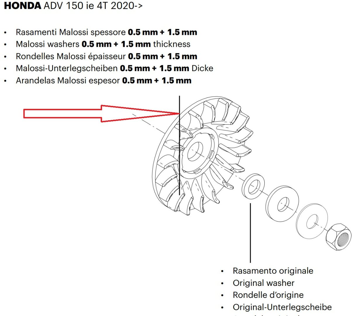

I switch original variator to Multivar and also change fixed pulley to malossi ventilvar. It is supplied with 2 different washer for different scooter model assembly. the problem is I am confused with supplied diagram because it look like it was misprinted
anyone can help me?

I put that red arrow to show that line which printed on Malossi's user manual, but I don't know where that line should pointed at

You put on the outer pulley, then the original washer that was on the scooter, then the two malossi washers, in either order, then the nut.
