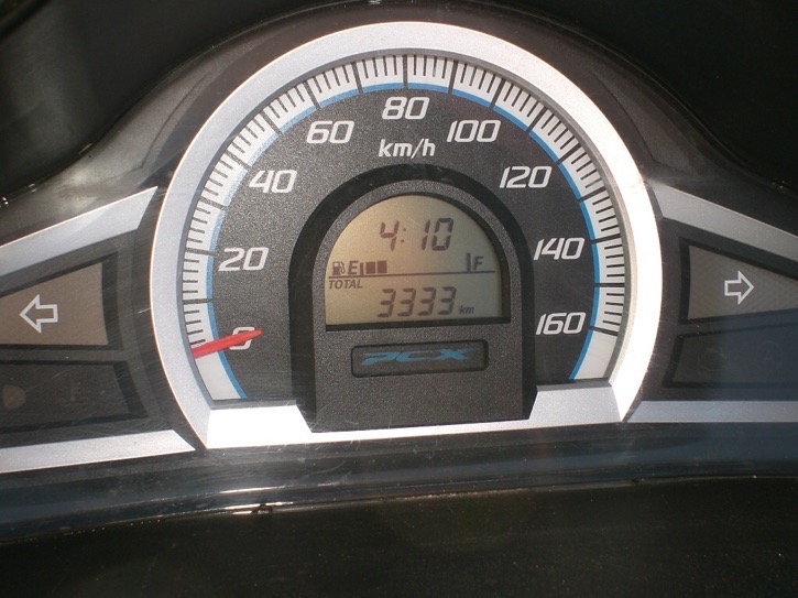

All, yesterday ended the season with a run 3333км, now waiting for spring
