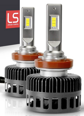

I would not recommend those style LED headlight bulbs.. If you are going to to go LED go with something like this. Cluster LED bulbs like the ones you bought are much more likely to short out quicker.
Screen Shot 2021-04-08 at 3.45.01 PM.png (163.93 KiB) Viewed 9803 times
Either way I would highly recommend HID over LED for longevity. Ive experimented a LOT with HID vs LED and LED never lasts as long. Not bc the LED is bad, but typically these cheap china made LEDs have much more opportunities to fail. HID is just 1 bulb.

I have installed LED bulbs in my older car and they usually burn out after 5 or 6 months. As expensive as it gets to replace those bulbs, the tradeoff is like night vs day. I solved that burn out problem by adding a DRL strip to my car and not turning the headlights on until dusk. By the way Conlite, the last led bulbs you showed a picture of as preferred, well those are what I have in my car. Even they burn out.

Mel46 wrote: Fri Apr 09, 2021 7:41 am By the way Conelite, the last led bulbs you showed a picture of as preferred, well those are what I have in my car. Even they burn out.

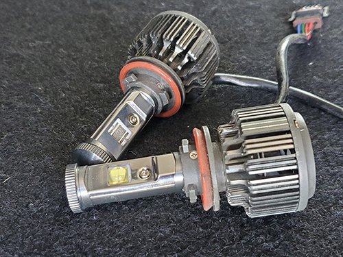

ha ha ha. Same. I switched from HID to LED's on my Element. They were great for maaaaybe a year then it started to dim. Didn't think much of it but just kept getting work. This is what was left. one unit had only 1 LED on, the second one both LED's actually de-soldered themselves off the housing. Back to HID's I went.

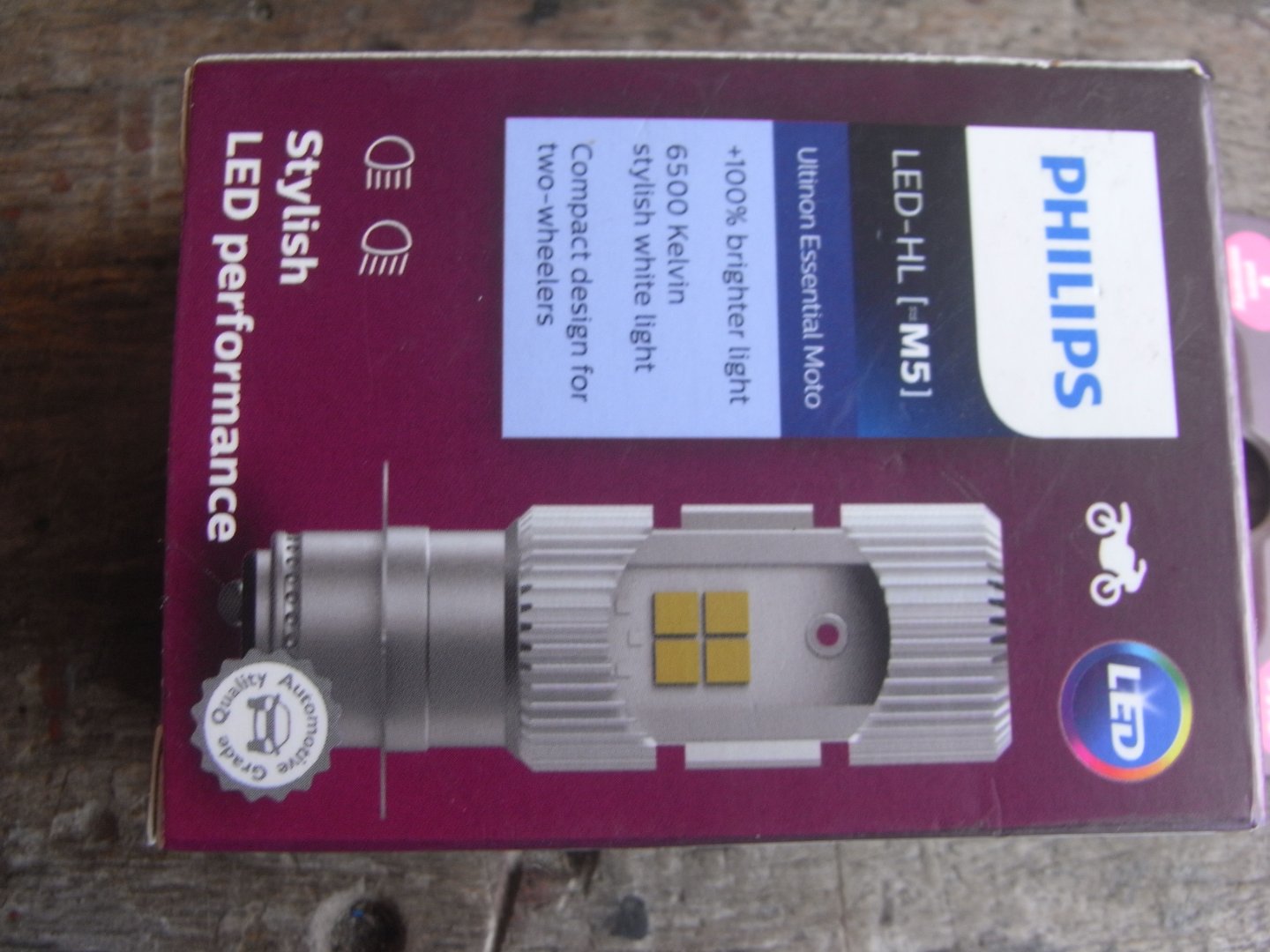

Hello I have tried a lot of diffrent led lights on my pcx 2013 and find out that philips -hl-M5 is very good very bright and good picture

affeno wrote: Mon Nov 29, 2021 11:01 pm Hello I have tried a lot of diffrent led lights on my pcx 2013 and find out that philips -hl-M5 is very good very bright and good picture
You change the HS5 socket?

I live in Thailand and this socket are on all small motorbikes like pcx

affeno wrote: Mon May 02, 2022 1:59 am I live in Thailand and this socket are on all small motorbikes like pcx
small motorbikes like the old Honda cg125, forget about installing those in a pcx, the connector doesnt even match! wtf
Honestly guys the best you can do is buy the proper halogen bulb, because the led simple does not offer the same light amount/quality/distribution (or whatever you wanna call it) to be reflected in the back of the headlamp in order to direct the beam correctly..... at the end at night either you will have to adjust the height upwards thus blinding other people with the light turning you into the most despicable human being on your area or, you wont see a thing because the beam points too low.
Sincerely I have a *really* small hope that some manufacturer would make a proper (homologated) HS5 retrofit because this precisely bulb as far as I know is not that common and we all know how capitalism works :lol: .... in the meanwhile we just have to deal with the "good 'ol halogen bulb"
