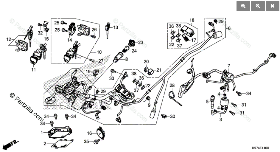

Seems pretty straight forward. You would need the #10 SWITCH ASSY., COMBINATION & LOCK
Screen Shot 2021-02-23 at 11.59.42 AM.png (308.1 KiB) Viewed 5917 times
