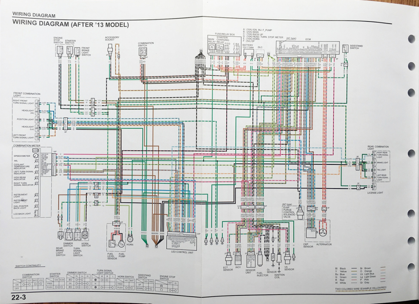

Mines a 2016 led uk model and I've been looking at the wiring diagram here https://www.hondapcx.org/viewtopic.php?f=15&t=771 but it's giving me a headache!

That may be an older wiring diagram that you are looking at. You have the LED version.
Try this one.
PCX LED resized.jpg (627.99 KiB) Viewed 13475 times

Mel - still shows one multi-way connector and different colours - just to check, we are talking about the combi meter connector?
Re: Engine light on and Speedo not moving!
Yes, but also be aware of the LED control unit.

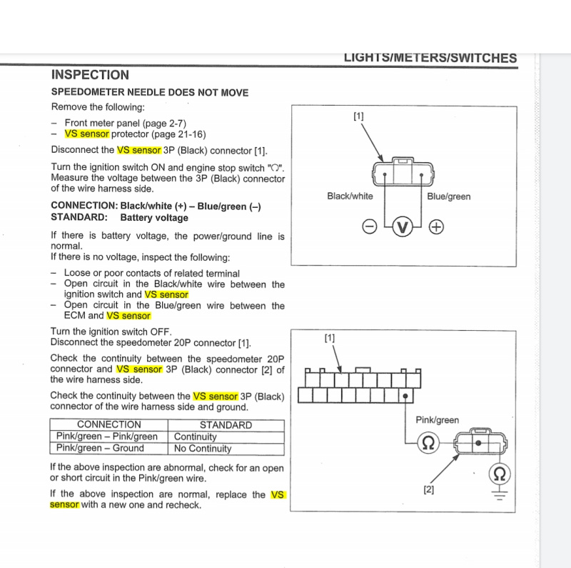

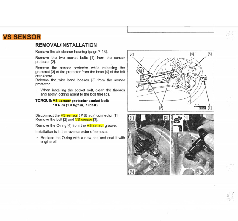

If the engine light comes on and it is part of the display, does the bike start? If the bike runs then that eliminates a lot of the wiring. Then you can pull the speedometer and check the connectors on it and to it. However, if everything else on the speedometer assembly works except the meter itself I would be inclined to pull the VS Sensor.
See page 21-17 of the service manual.

Maybe this will help.
vs sensor installation.jpg (145.86 KiB) Viewed 13455 times
vs sensor inspection.jpg (168.07 KiB) Viewed 13456 times
