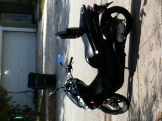

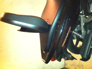

back rest i fitted to the seat using the seat bump attachment holes

What kind of backrest is it? How does it feel when you are riding? Is it sturdy enough to attach a bag to it for extra storage?

And how do you get on the bike? As I'm an old motorbiker I flick my leg over the back of the seat. Couldnt do that with that rest there!
Re: back rest
im 5'8" it is the backrest from a shcwin stationary bike that i had pulled out of the garbage
i removed the seat bump from my seat and utilized the holes to attach the backrest
i used some carpenters hurricane clips for roofing that i modified to work as "L" brackets i had been looking every where for a drivers backrest and found nothing that was good so
i made this it feels great when i ride it has a slight lean forward when not sitting on the bike but when you get on it it supports my back very well it also has an adjustable lumbar support that is great for long rides

i do have to step through the center of the bike but it doesnt bother me

oh and yes it will hold a bag or box behind it it has a built in pocket on the back of it but its about the same size as a laptop so not very big

Bag or laptop holding is handy! How about if you have a pillion, can they hang onto it. Are they allowed to sit backwards and also use it as a backrest?

WhiteNoise, that site is awesome i think the backrest on the new silver wing could proly be modified to fit the pcx
thanx it dose work well for me.
i really enjoy repurposeing junk into useful things this is one of my best "freecycles" yet

I wonder if, after a while, leaning against such a tall backrest would weaken the plastic where it attaches and cause the seat plastic to crack. Maybe that is why Honda put such a tiny backrest on to begin with. Please keep us informed as to how this backrest holds up over time.
