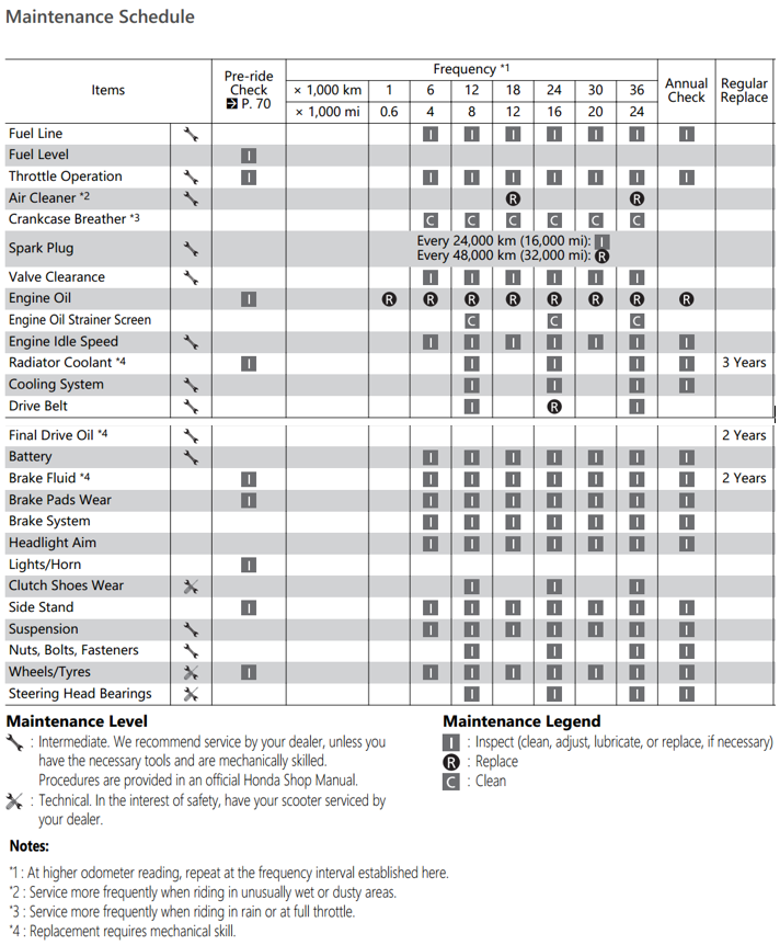

Hi
Does someone know what work has to be done for the 12000 miles service?
My local Honda dealer is quoting me 160£, twice as much then the 8000m service.
Thanks. :)

You'll need a new drive belt and the brake fluid and coolant will need changing.

Here is 2018 Forza 125 Maintenance Schedule
Maintenance Schedule.png (218.28 KiB) Viewed 7689 times

I'll take the liberty to hijack this thread a little if I may as 12k service include valve clearance inspection.
