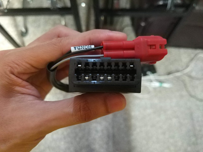

can some one help.? i need diagram for this.
i need to connect it bluetooth obd2 so that i can see the rpm and tune the variators
thank you!

I just got adapter from Webike Japan made by Kitaco but still waiting for Bluetooth scanner. BTW how do I take the cover off the 4-pin port on the bike? I can't seem to find the tabs to unhook..

hi. is this what you want?
https://ibb.co/1dJSxNk
Conelite
Posts: 382
Color: Blue
Re: obd2 port 4 pin to 16 pin wiring diagram help
Post by Conelite »
I have the Same Kitaco adaptor and the same bluetooth OBDII scanner which does not work at all.
BRM2, Have you attempted to repin the 16 to the 4 corners like the diagram shows?

Hello, I have tried to make an adapter with the diagram in the attached photograph for conelit and I have not had results. Are you sure that the arrangement of the cables is correct?

Conelite wrote:I have the Same Kitaco adaptor and the same bluetooth OBDII scanner which does not work at all.
hello conelite,
I have checked your diagram and have had no luck. Are you sure the diagram is correct? I have also found the following diagram that looks very different from the kitaco adapter.
[img]https://kds-online.de/images/product_im ... 0x0780.jpg[/img]

The issue seems to revolve around pin 9 of the OBD connector as the other 3 are common standards - pin 9 is one of the model specific ones.
