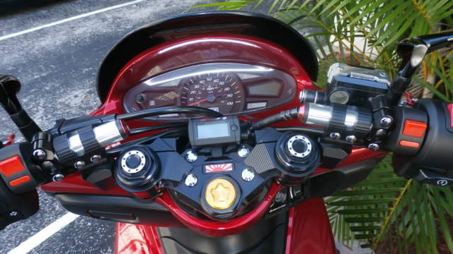

Heres a look at the KOSO mini tach install
- P8030399.JPG (60.28 KiB) Viewed 8736 times
My PCX mod build here..
