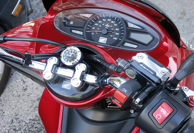

Dash view includes clock, bikerz bar clamps, and bikerz master cylinder cover. These as supplied were a little too 'pyrimidal' for my taste so they were filed, draw filed, and wet and dryed before a final polish for the desired look. Also shown is the non chromed stem cover off a Forza, yes it fits, just. I prefered the look over the stock chromed cover

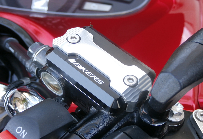

Close up of master cylinder cover

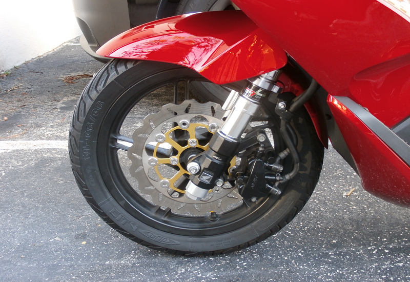

Trusty fork lowers have been fitted with YSS PDD valves, 2 turns in (thanks Oyobun for recommendations and info) also 15w motul fork oil. Oversized rotor and adapter modded to trusty forks. Ride and braking much improved over stock.

What is the switch for on the right handlebar, close to the master cylinder? I couldn't get any of my switches to fit there because it was just too tight of an area.
- k2apache6.0
- Posts: 507
Re: k2apache's 6.0 2013 PCX Mod thread
Getting to that Mel, part of the HID/LED lighting setupMel46 wrote:What is the switch for on the right handlebar, close to the master cylinder? I couldn't get any of my switches to fit there because it was just too tight of an area.

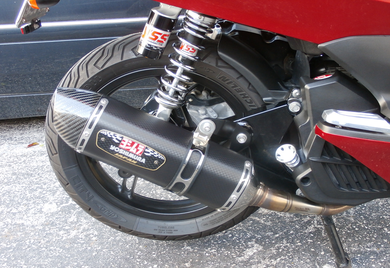

- Posts: 507
Yoshimura performance exhaust system. As expected from Yoshi everything is 1st class and the fitment is near perfect, bit louder thsn I'd like but hey its a Yoshimura!
- pcx yoshimura.png (906.13 KiB) Viewed 12879 times

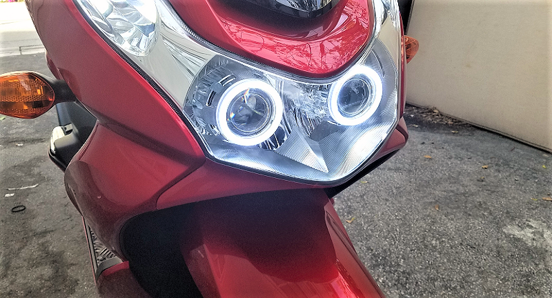

Prepping for the HID /halos/ cree spots. Do not buy the powerbypcx setup, it melted my reflector, this is my own retrofit using parts from the Euro headlamp and the US headlamp with 1/2" larger (2 1/2" projectors) with COB LED halos

View of retrofit with halos lit, much brighter than CCFL's

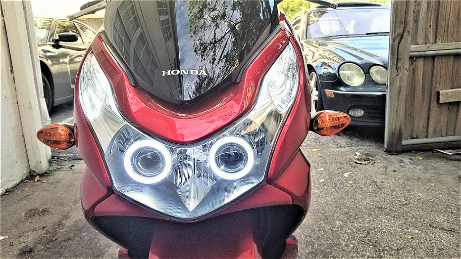

Halos on and cree spots in the Euro turn signal sockets, I have some more powerfull cree spots ready too install at the ready

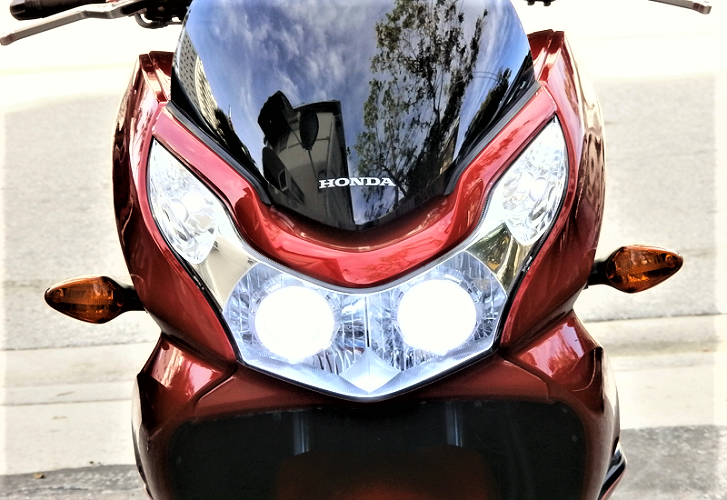

Halos on, spots on, and HID headlights on highbeam. I wired the system thus...
Halos on everything else off
Halos on low beams on
Halos on high beams on
Halos on high beams on cree spots on
High beams on halos off cree spots on
low beams on halos off cree spots off
This required an additional 2 switches handlebar mounted becuse the HID's are not twin 'filament' bulbs, they us a mechanical shutter within the projector housing. Performance is about 150-200% better than the stock halogens

Mel, these are just on/off 7/8" handlebar switches I found on ebay. They're small enough to fit before the bend and so far no reliability issues at all. They are very positive in action and audiable to boot. I use one for the Halos, and one for the high beams/crees on/off, the highbeams just require the projector shutter to raise so the electrical current is small. I think the switches are rated about 10AMel46 wrote:What is the switch for on the right handlebar, close to the master cylinder? I couldn't get any of my switches to fit there because it was just too tight of an area.
