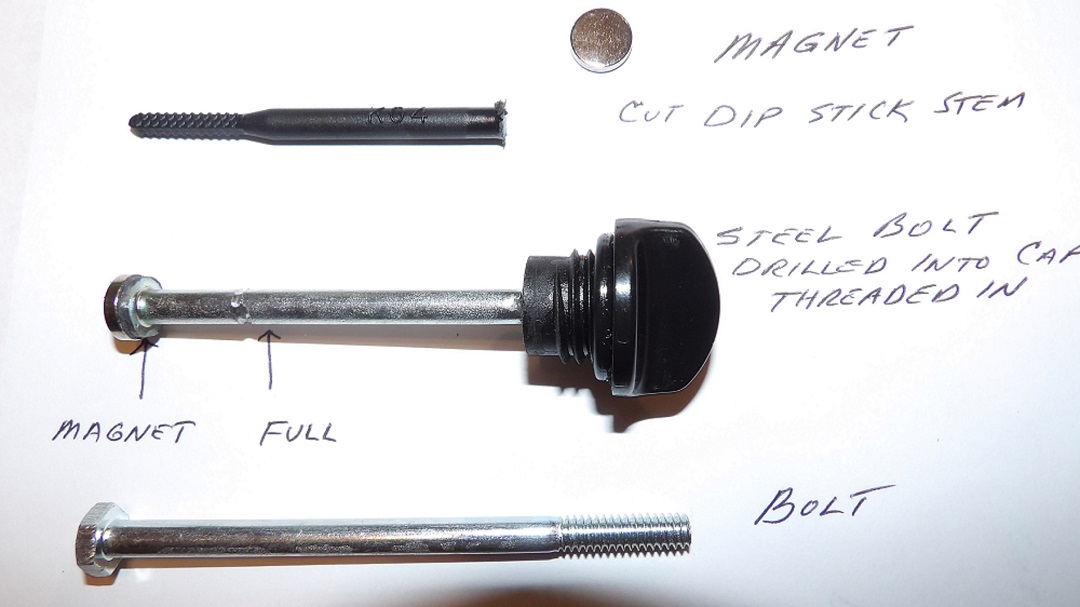

This is an easy DIY project if you're sitting around bored with nothing to do. Takes about 15 -20 minutes . This project is making a magnetic dip stick just to see if you have any metallic particles running around in your engine. Yes, you most likely have a magnetic drain plug that serves this purpose but what the hell a little more attraction cant hurt. The picture below should self explain this project. The magnet is neodymium and very strong attracted to the bolt but I supplemented it by using JB weld to make sure it won't come off.As with all projects make sure you follow Honda and service manual requirements

This above modification should not be used with motor running. I believe you can , but the crankshaft may attract it and pull the magnet off that is why I also recommend caution. I have used it with no issues but would not recommend this to anyone since there is a risk associated with it. Just for illustration purposes.

I like your idea better. There is a risk of the magnet coming off but I can tell you I did this method before and it never came off after years of usage, however I also believe in Murphy's law and if it can happen it will, thats why I would disuade anyone from using the stick on method. Thanks for bringing your idea to the table.. it got lots of us thinking I'm sure..
