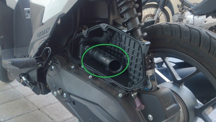

I was waiting for Mav to make a special edition fast PCX for CaliCal. LOL
This is the snorkel he was talking about..(photo Not pcx but it is similar to this)
Tried removing it once but I don't like the snarling sound the scoot is making..

alx123 wrote:this is the snorkel he was talking about..(photo not pcx but it is similar to this)
Yep - I was just trying to politely say "I really don't think that is a good idea".

I'm pretty sure that's to make the air intake process more quiet.
I'm not even sure if we should call it a snorkel at all..

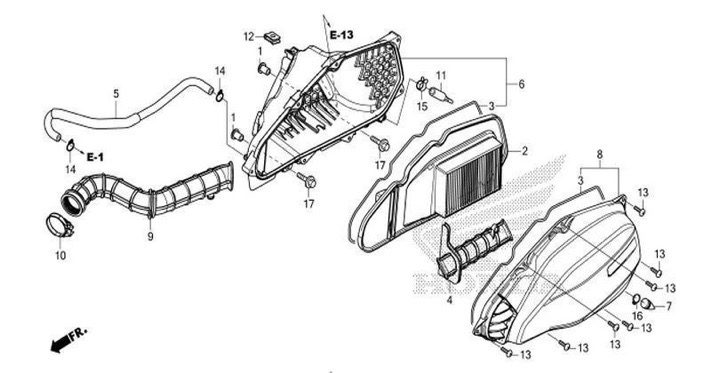

The photo above is wrong, my apologies..
the snorkel to be removed is the Part no. 4 in this diagram
