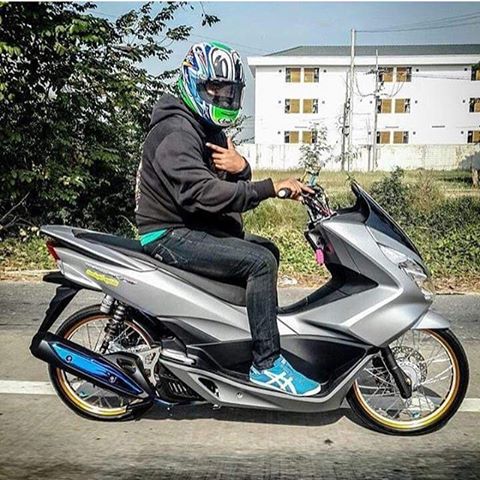

I got outran by almost any 150 and below moped around here (Bangkok). The 2016 up model is slow, engine designed for fuel efficiency, and the PCx is heavy for its displacement. That Vespa probably outran you because it is lighter.
NMAX and Aerox run circles around me here. I call mine a chicken chaser.
But 13g rollers might help a little. Thai people changed to thinner tires and ditch the alloy wheels for spokes wheels.

these guys always leave me in smokes and dusts all the time..
their stock exhaust is also modified for less restriction, i can tell by the way it sounds..
and probably some variator mods for sure..
i was always left with the chickens to deal with..

Do you know the benefits of those spoked wheels? Faster scoot? lower rolling resistance?

^^ that will allow them to put on the thinnest tires possible, thus lighter and faster.

Do you know where one could purchase those?
Sounds interesting.

I want to mention if you used those bicycle wheels on a PCX you would lose weight and mass for sure but wouldn't you bust your butt pretty quick on just about any surface or weather condition that was even slightly less than bone dry and clear of all debris?
Yes, I think you would :D I'll run with the chickens thank you
