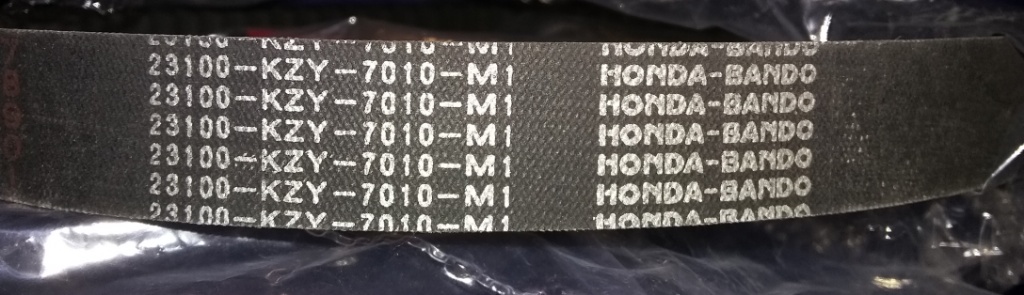

Well, at least I know what belt fits my 2013 PCX 150. I wish I could help on the other belts. I kept my old belt when I bought a new one from the dealer, so I have both the package that the new belt came in, plus the original belt with its part number. I know that there was some discussion concerning belt part numbers for the pcx 150 as well, so I am attaching a picture of the belt number for a 2013 pcx 150 from the belt that came on my machine when I purchased it.
Maybe this will help those of you who have the early (2013) Esp PCX150
