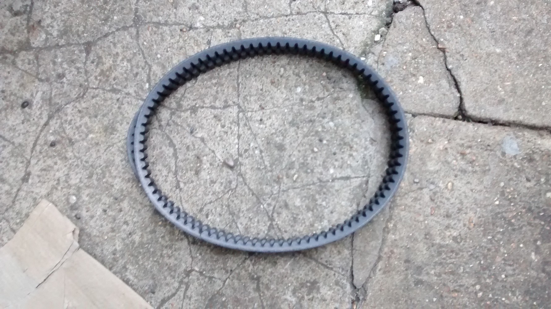

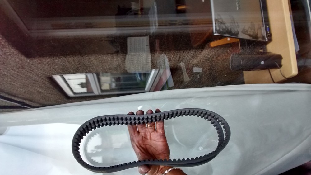

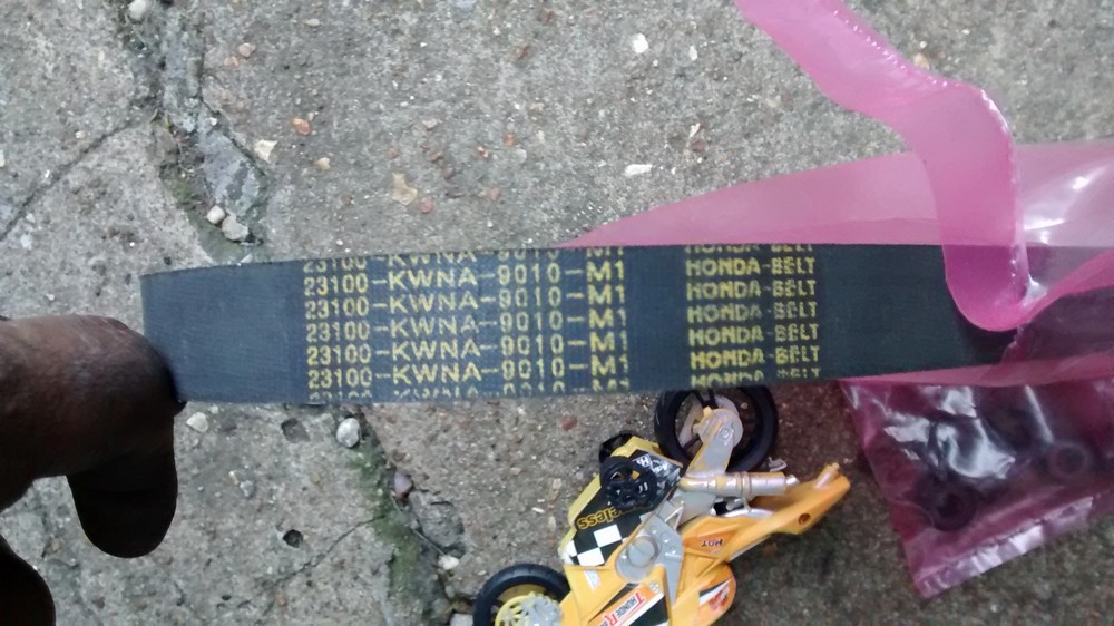

Maddie you are right, However it's not because I did not put it tight enough. I remove the belt and compare them and found that the one I bought is slightly bigger than the original. (See pics) I refit the original and the noise is gone and I could once again reach 65 mph. I will now have to get me another one

The one on the picture that says "Honda-belt" on it is a fake.
A genuine Honda belt will say "Mitsuboshi" on it.

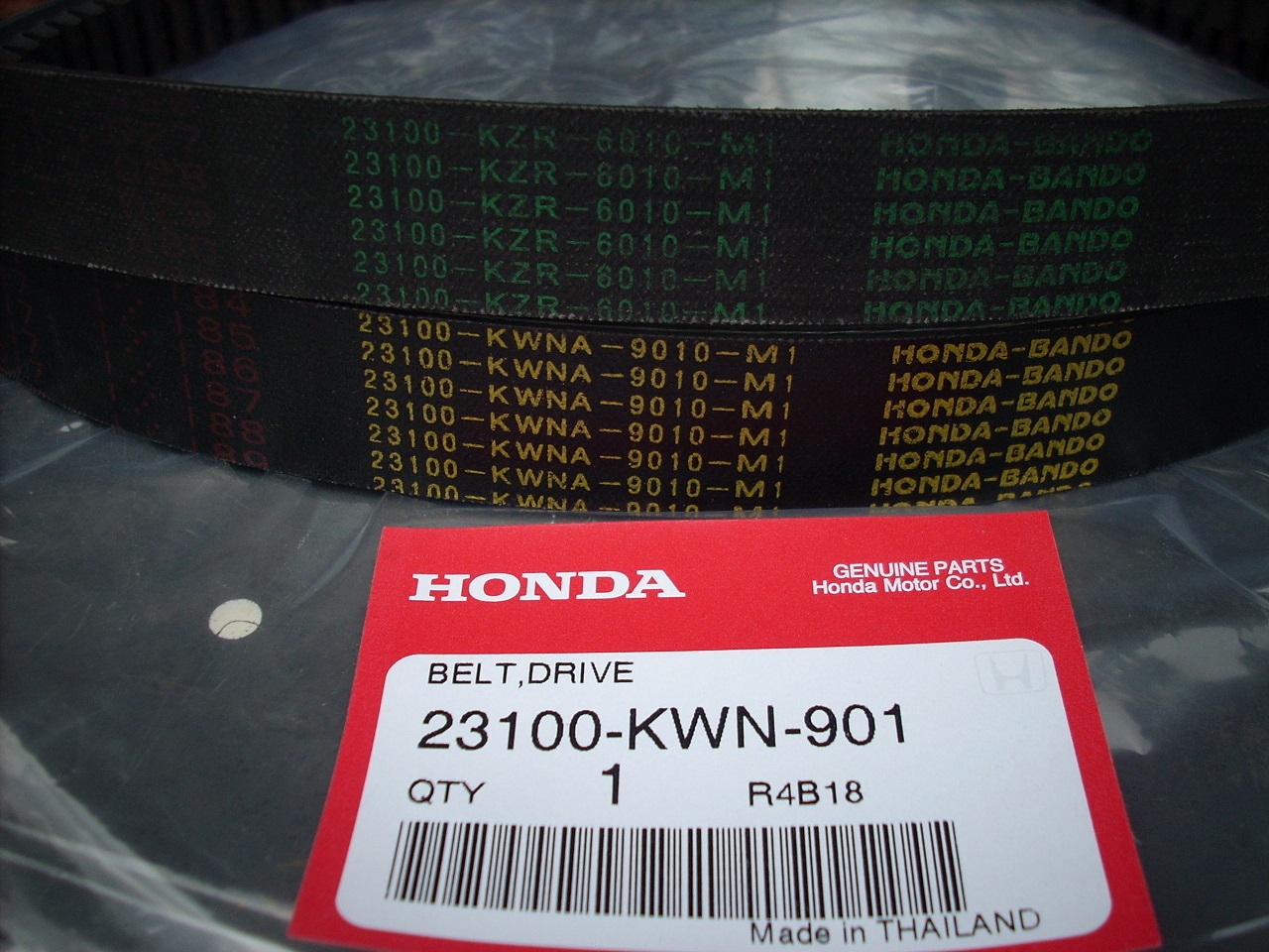

I changed my drive belt today, using a Honda 23100-KWN-901.
Is this the correct belt for the 2013 UK spec 125?
The new and old belts are shown in the picture below.
They are identical in dimensions but carry different part numbers.

Re: Belt and roller change
23100KWN711 is my GENUINE on the EsP PCX 125 (came from Japan)
So I do think that
23100KWN711
23100KZR601
23100KWN901
Same ! Not ? )
So I do think that
23100KWN711
23100KZR601
23100KWN901
Same ! Not ? )
